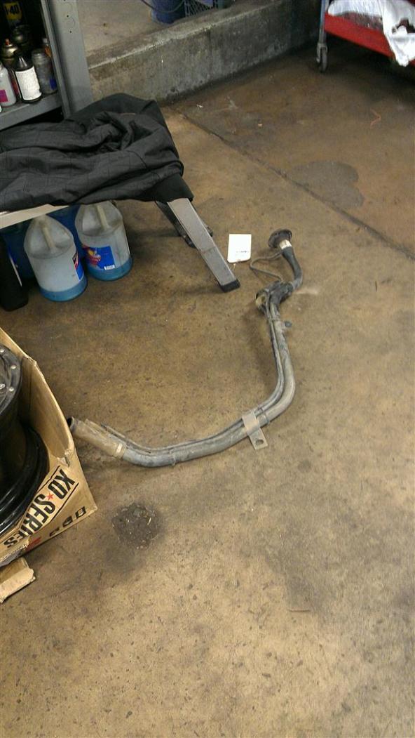

Happy to report my Durango has been fixed! Props to Perkins Dodge in Colorado Springs. Ended up spending $380 on a tranny flush and replacing the tranny cooler lines that were leaking (common issue apparently). But the fuel fix was free
Here is a video of my fillup tonight after leaving the dealer (put in 21 gallons):
http://www.youtube.com/watch?v=cWvLj...L2lZJfvPu3HoLz
Picture of the part they replaced (this is the old one):
