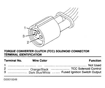

There are two wires to the TCC solenoid plug.
One wire is with dark blue/white stripes, and the other wire is with orange/black stripes.
The dark blue/white should have 12 volts on it when the ignition is on.
The orange/black wire should have less than 5 ohms resistance.
If the problem is fixed, the trouble code will goes away. You would feel the TCC engaged above 40 mph. It feel just like another shift.
1st gear - 2nd gear - 3rd gear - and then the TCC is engaged.
Additional information:

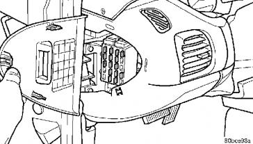

Dark blue/white wire is supplied with 12 volts through fuse #10 (If you don't get more than 10 volts on this wire, fuse #10 maybe blown).
Orange/black wire goes to the PCM (Powertrain Control Module). The PCM controls the TCC by grounding this wire.
Fuse #10 is in the cabin
