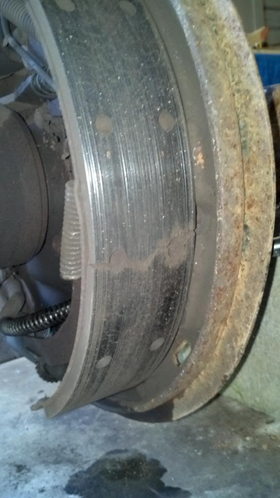

I found the time to remove both drums off the Dana 60, what a mess. The star adjusters where all the way out, cracked shoes on both sides, the drums are machined past the safe zone. So time for new drums, shoes for the rear and new pads and calipers for the front 60.

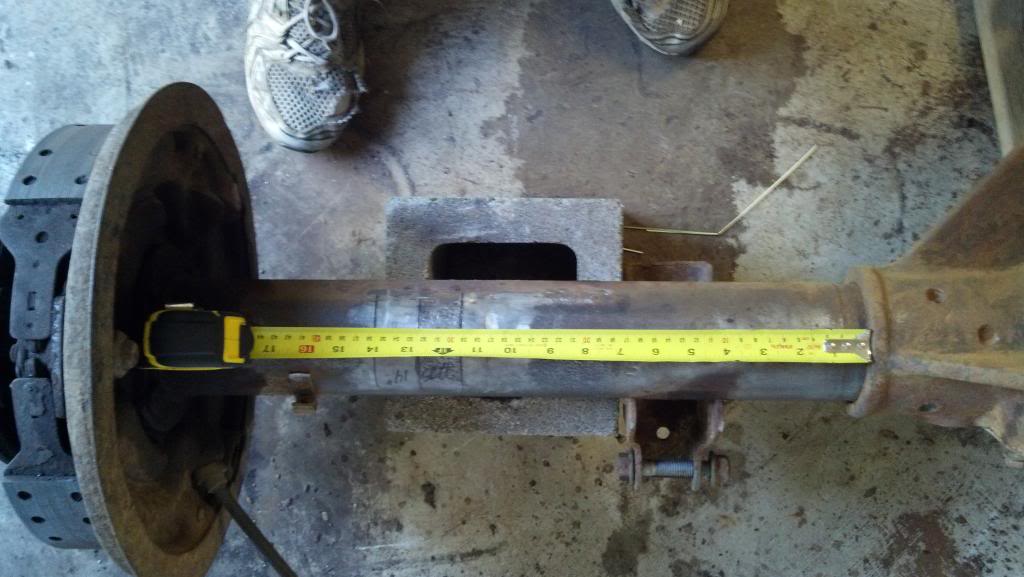

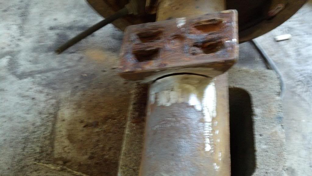

Also removed one of the spring perches.
