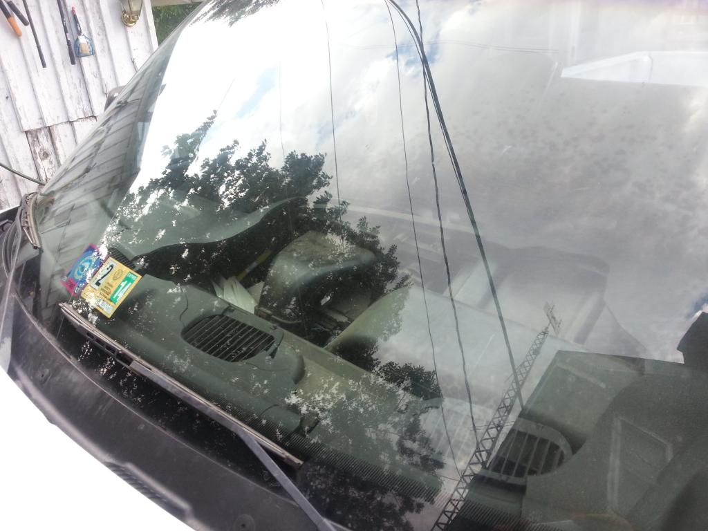

Originally Posted by stewie01
There are some nice black suede carpet pads that might look ok....
Mine looks exactly the same, and I'm beginning to think $388 for a new one isn't looking too bad after all, but then you put the price of a new bezel with that and wellllllllllllll.................
At least installing a radio is easy as hell at that point lol

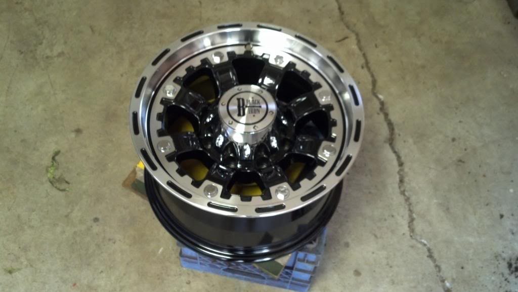

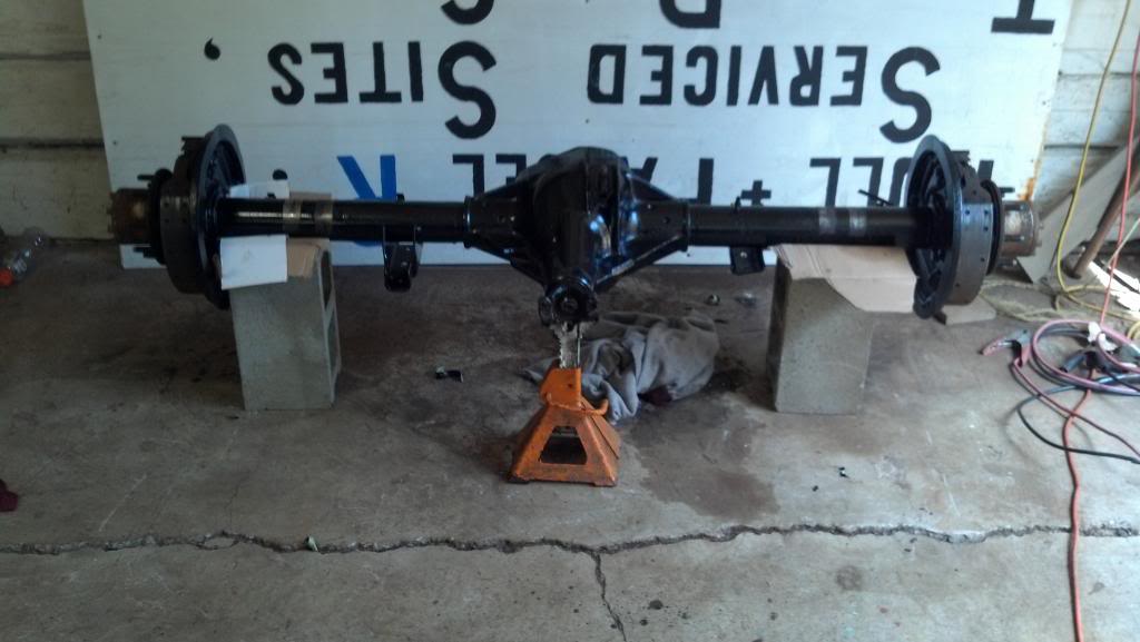

Put gas in it, drove it to Salmonarm to pick up the new wheels/rims, they will work for the summer then sold as I will be going up to a 17-18" rim next year. The rear diff is almost ready to go under the truck just waiting on a Spicer part pinion yoke 2-4-7681-1X for 7290 joint to fit the Dana 60. There are NO combination u joints for this swap (7290 to 1410) and the 9.25 yoke will NOT fit a Dana 60 close but not close enough. So far it looks like no ds mod's are needed, but I will find out more over this weekend, all by tape measure so far, time will tell.
New Black Iron Outcast Wheels 16x8.5 8 bolt.

60 all cleaned up and painted with Por-15, great stuff. Still need to change out the shoes and wheel cylds, make new hardlines as well.

Those rims look sweet merc. Are you gonna put them on the truck or...? (we need pics )
