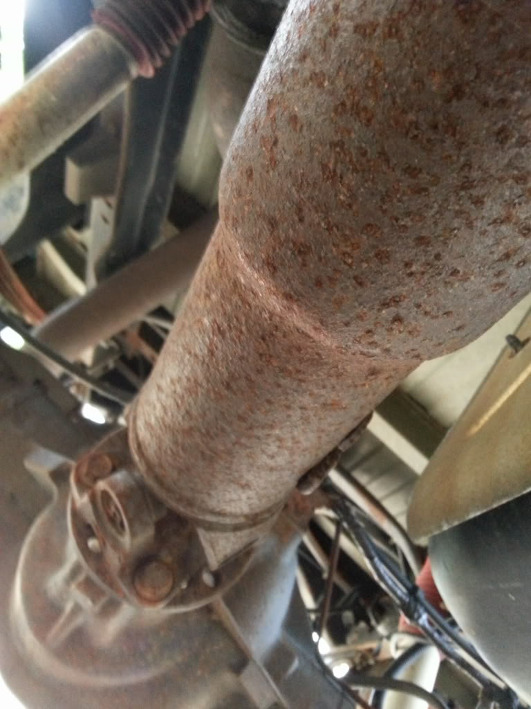

ok, merc.... if i go weld to weld its 59 inches. if i go from the step down, its 54 inches.
heres a pic of the step down.
Mine is in at 60" weld to weld, the 9.25 from the axle centerline to u joint center is 11.75" and the 60 is 13.25" difference of 1.5" I need to see how much slip I have in the upper slip-yoke to see if I can use my DS without cutting it or find a 2500 58" DS or one like yours. For my swap your DS would be just about right.
