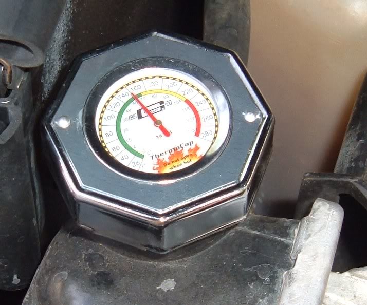

I was all set to dive in to do a water pump replacement and a timing set while I was in deep, new hoses, thermostat, and so on, but it was bugging the heck out of me that I didn't know precisely where the coolant was coming from. I'd hunted and cussed for a cumulative total of about three and a half hours with a big bright flashlight, a smaller bendy light, two different inspection mirrors, rags and paper towels, and a mood that got sourer by the minute.
Today I decided that it was time to get heart attack serious about finding that stinking leak. I just didn't want to tear into the timing cover and catch a radiator leak out of the corner of my eye, ya know?
About an hour into it today, I spotted the culprit. I don't know how it got past me before, but I figure I was lucky to catch it while it was acting up:
It was leaking in two places around the gauge face, the fan was drawing the coolant through the gap between the radiator and shroud and blowing it onto the engine. I put the old cap back on, topped up and burped, and everything's bone dry again. FINALLY!
