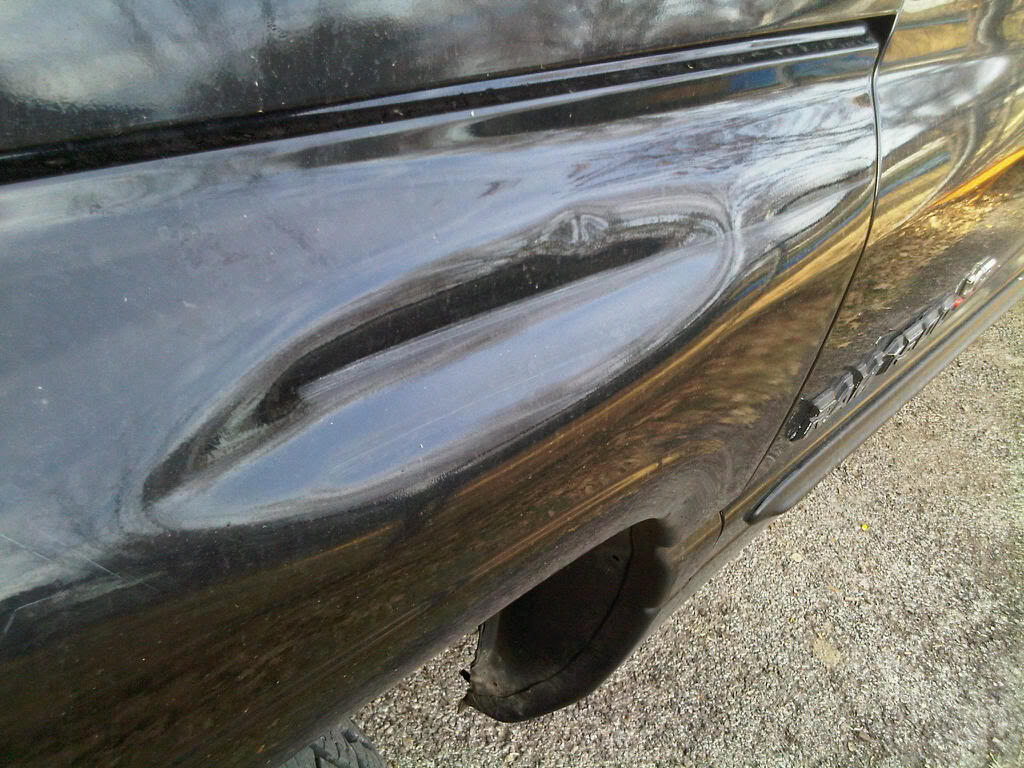

Dent sanded out:
Studs welded on:
Dent pulled out:

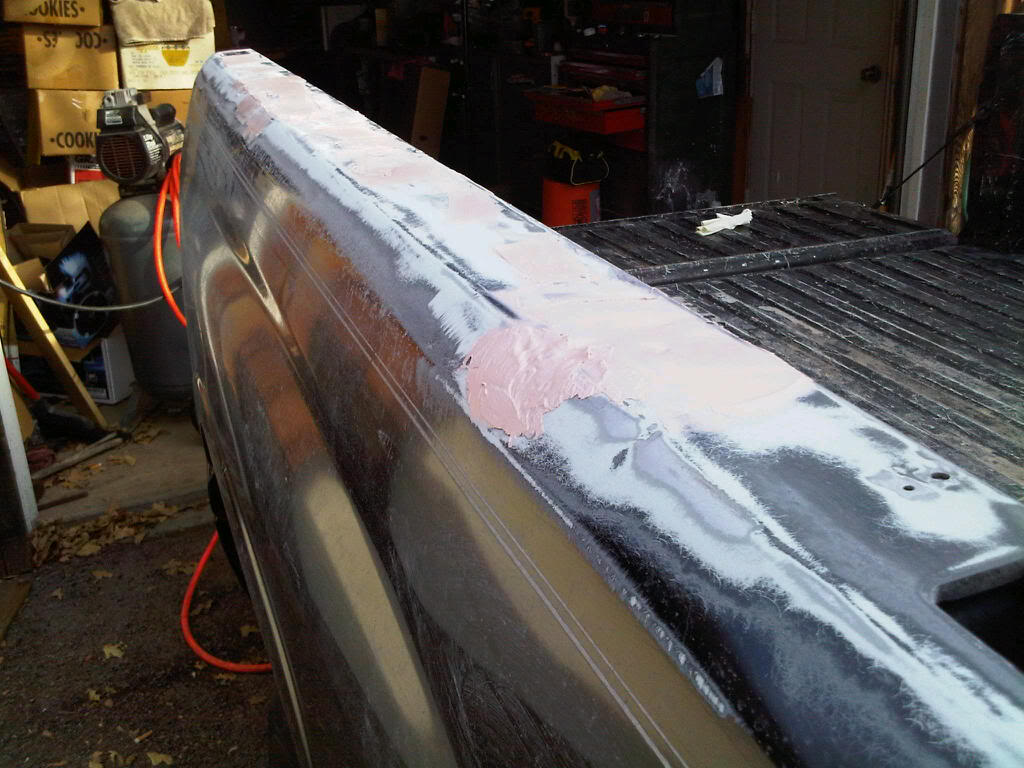

Bondo on bedrail:

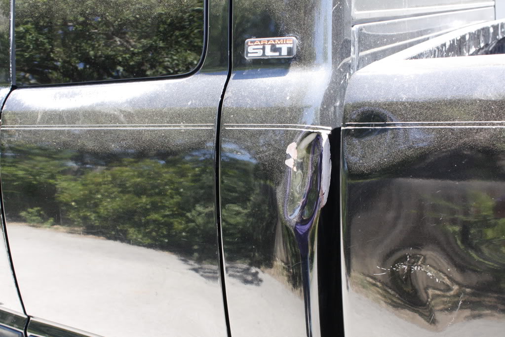

damn you have lots of dents

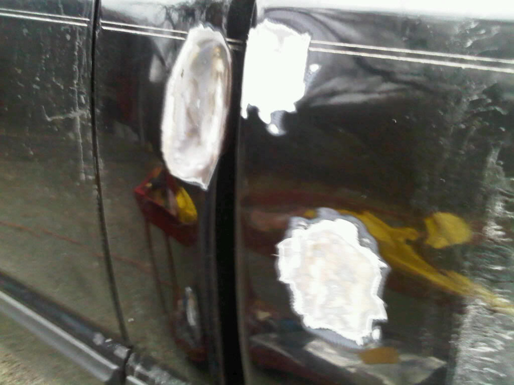

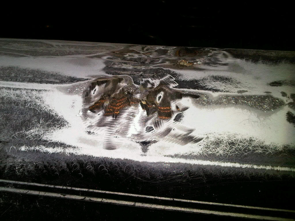

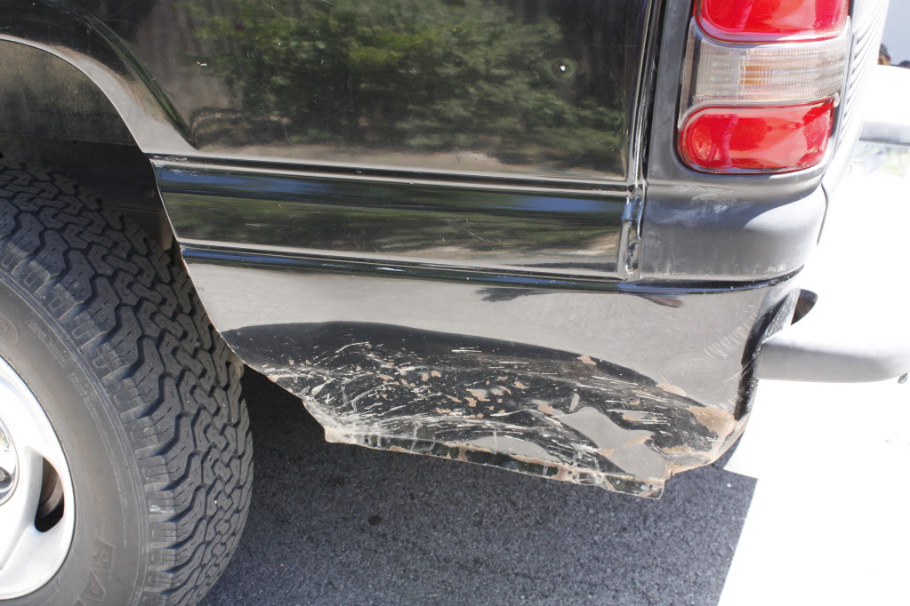

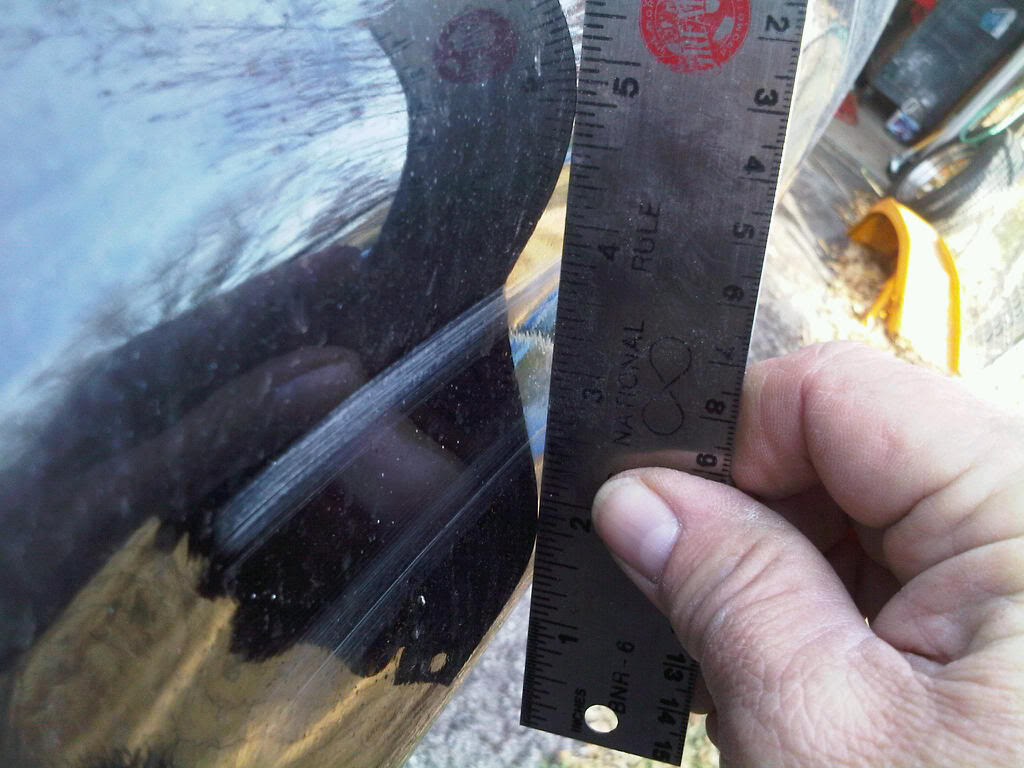

I was able to do a little work on the body again this afternoon.
Sanded paint from dents at the front of the drivers side bed and the corner of the cab:

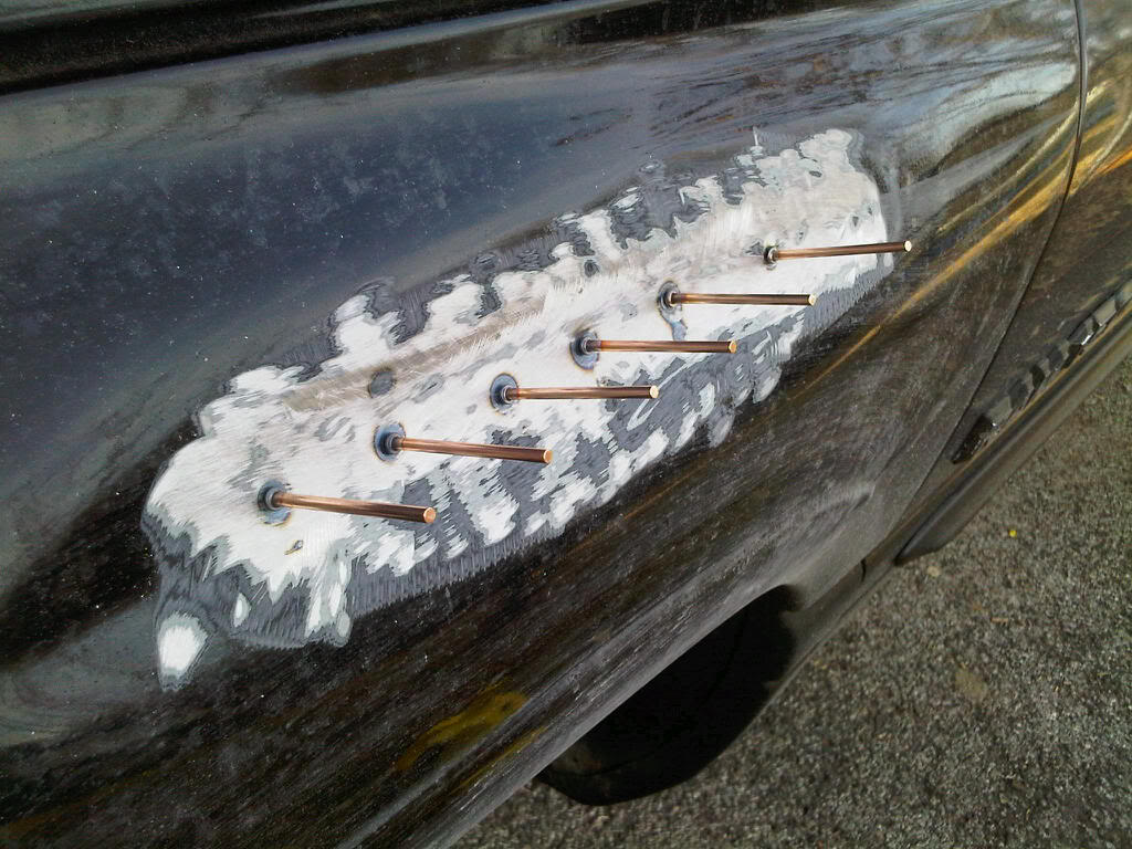

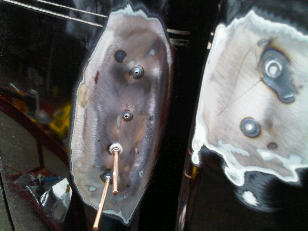

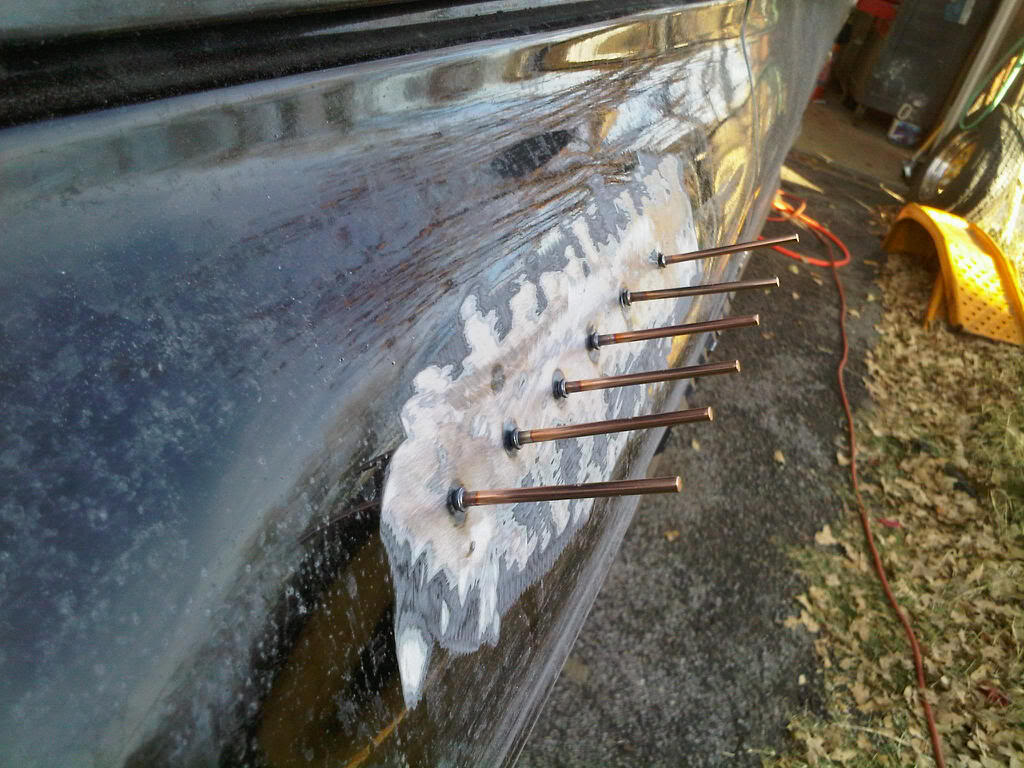

Welded a few studs to pull dents:

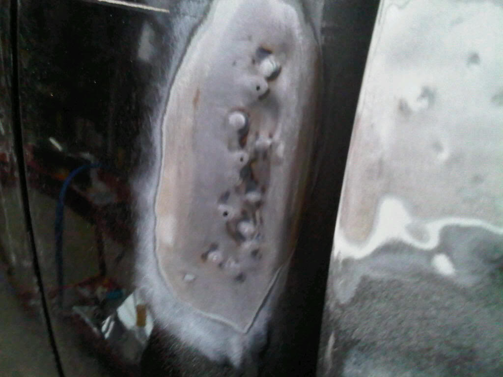

Dents pulled out some. Cab corner needed a few more studs as you can see part of the dent did not pull. Now the dent is better and studs sanded down. Deepest part of dent now is about 1/16”.

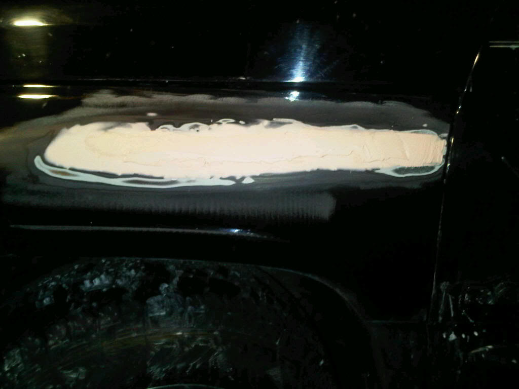

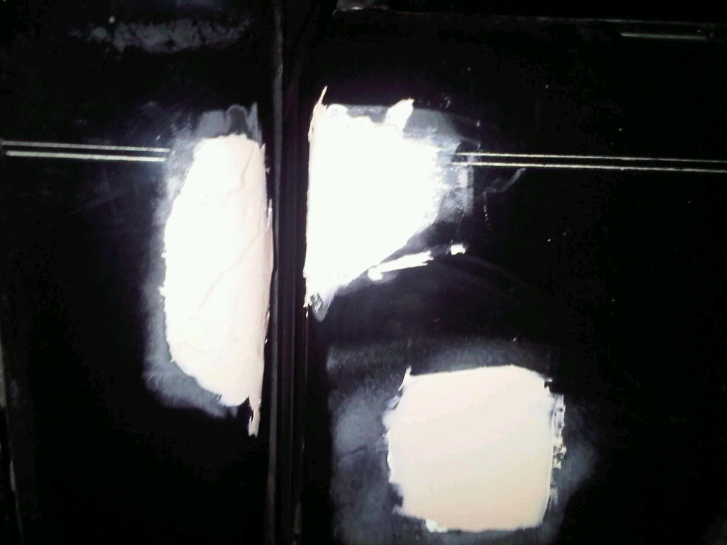

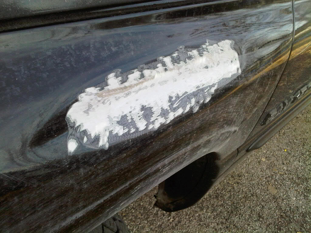

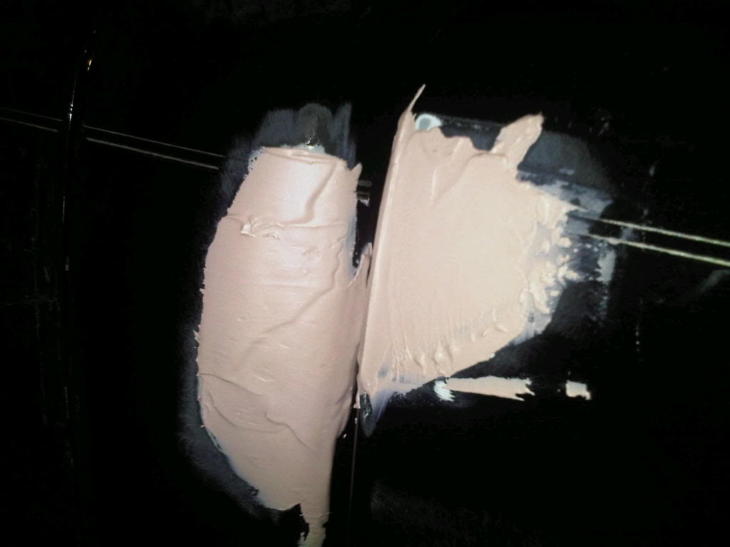

Bondo on front fender that was pulled earlier this week.:

make sure you weld the holes up if you break off the studs. if you leave the holes water can get behind and start to bubble the paint over time. if your going to keep the truck i would spray epoxy primer over the body fill and area after blocking then a high build primer. you can use spray fill,upol works good so does sikkins but you need a gun with a 2.5 minimum tip to spray. spray fill will hide a lot of pin holes and imperfections but you have to put a final coat of primer over top. what type of paint are you using? up in canada it's mostly water based very expencive to do a vehicle

looks good. if done right bondo is fine. used some over the wheel wells on my 91 and 1 side was done right and the other side never got sealed. the side that did not get sealed took about 2 years to show itself and the side that got sealed is barely noticeable 4 years later

Thanks. As soon as I get each side done I plan to prime and paint. Going to pick up paint tomorrow. When both sidees are don I'll do tailgate and hood, then bang dents out of bed and put on bedliner. Hope it will look like a new truck when done. Trying to keep bondo thin. I know that if it is too thick it will not hold as well.
Old Dec 2, 2011 | 04:31 AM
kejobe's Avatar
kejobe
Joined: Aug 2010
Posts: 2,241
Likes: 12
From: Ohio
1/8" max is whats recommended on filler. Ive seen a whole lot thicker, about 2" before and held fine for a few months, but thats about it.
