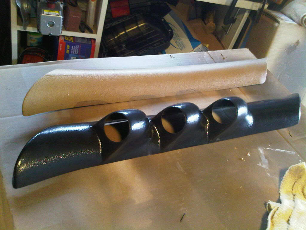

Then decided to install new gauge pod, which was black so I pulled off both a pillar covers. To make sure color matched I wanted to prime all pieces with a light primer.

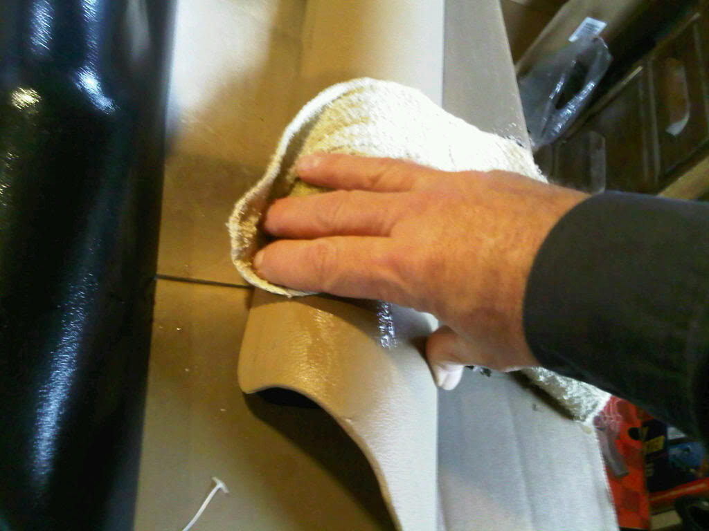

Washing pieces to remove any dust or oily reside.

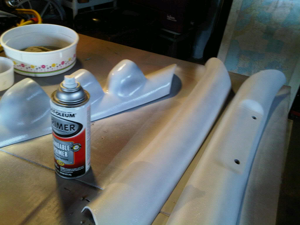

Primer sprayed on:

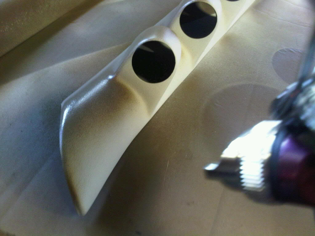

Spraying pod:

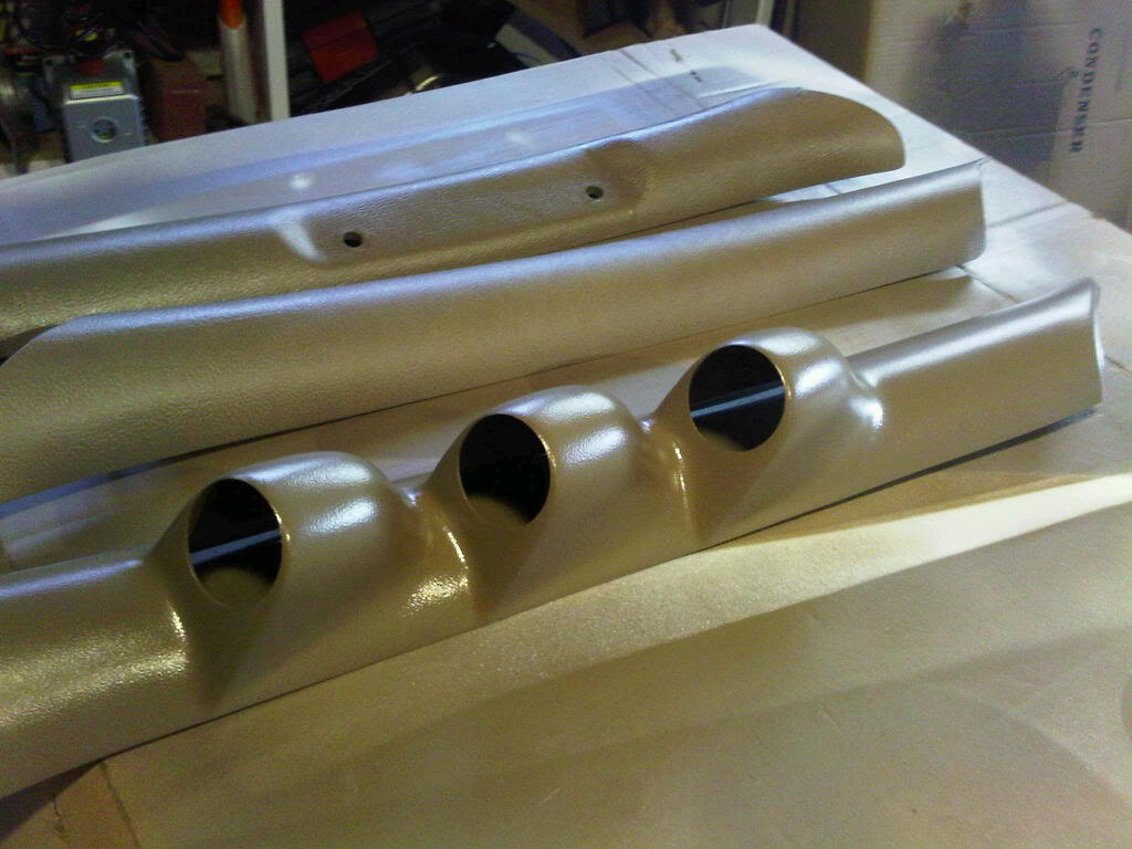

Pod and a pillar covers finished:
