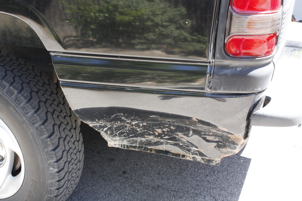

took off work today ..... cause it's Friday, I suppose.....
Went to Abilene to PPG distributor and boutght primer, sealer, base, and clear as well as other supplies. Set me back $682.00. Guess it would have been less if I opted for the cheaper line of paint, AND not gotten metallic black. Darn base was $196.00 for a gallon. Should be enough to repaint Ram and do touch up on Yota.
Looked at color samples for Jag and VW. Thinking a pearl metallic burgandy for Jag and candy red for VW. Gotta see how the Ram comes out first. May determine whether I want to tackle the others! Going to get down to freezing this weekend, so may only get to do some more dent pulling.
Bought a welder also today so might get lower fender panels welded in.
