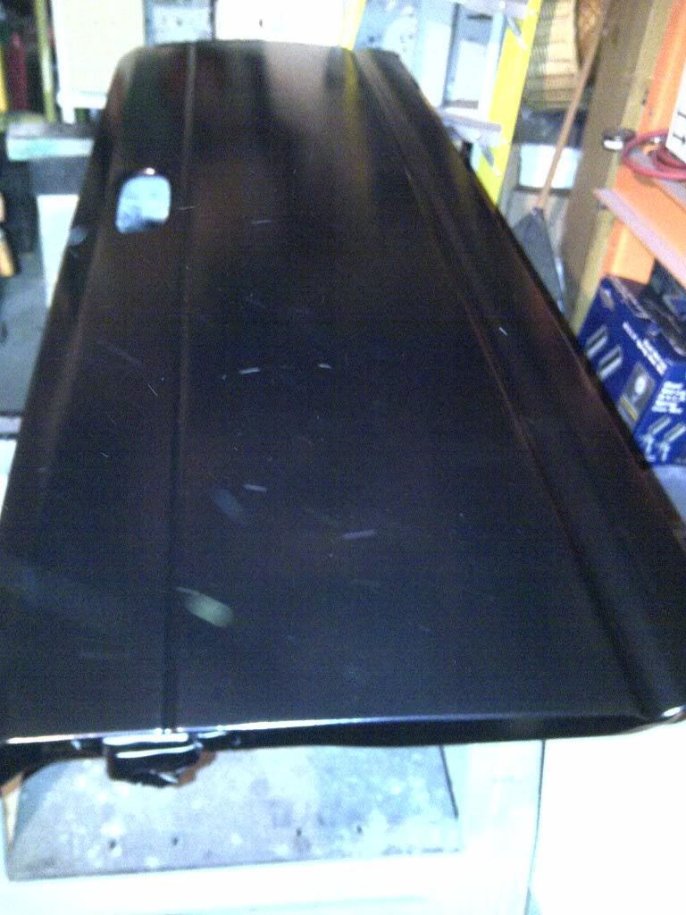

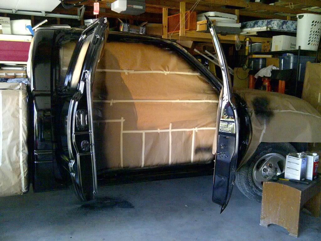

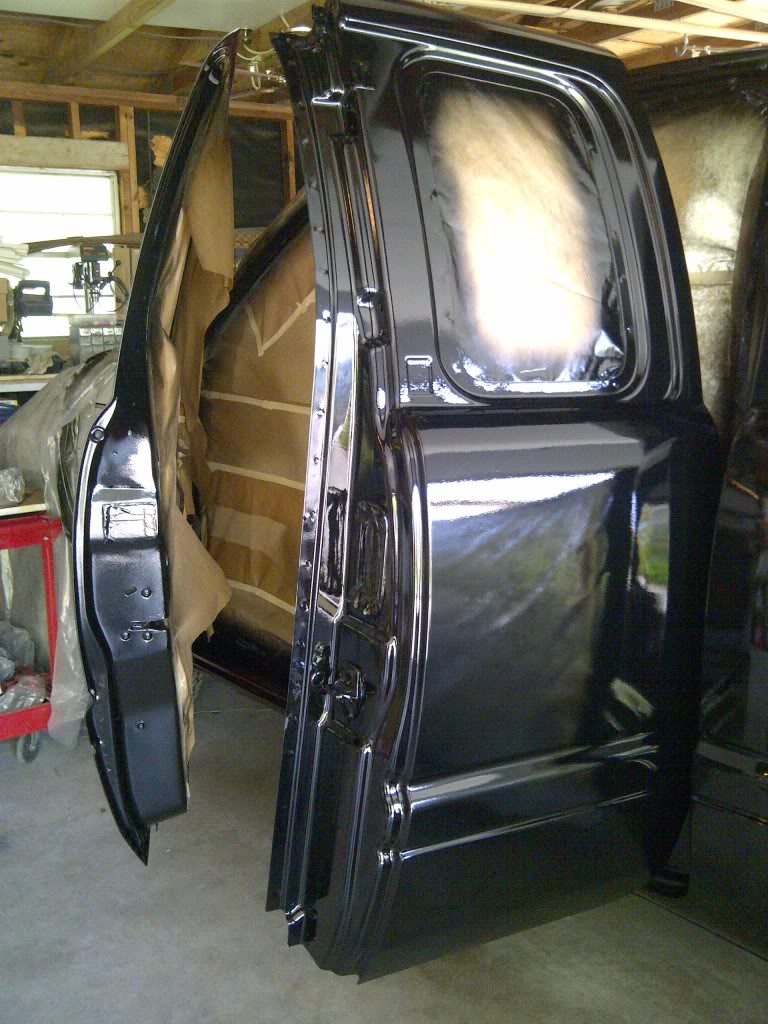

Yesterday’s work – clear on doors, door edges, and inside of doors and rocker panel.
The stuff at the bottom on the rocker is masking paper - closed the door too soon and it stuck to rocker. May try to use some reducer on a rag to see if I can clean it off. If not, sand and recoat.....grrrrrr....

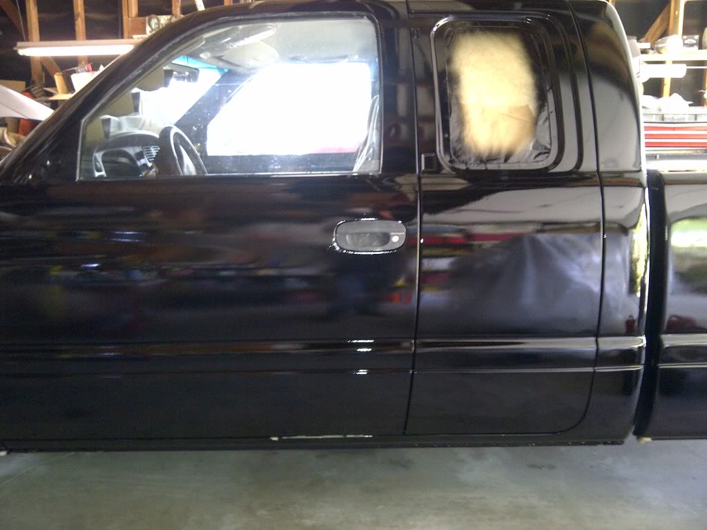

Shot two coats of clear on passenger side today as there were too many flying bugs in the garage last night and I did not want to have them be tiny ornaments this morning.
Shooting on the practice hood makes getting spray gun set correctly much easier with fewer oooops to correct on the Ram.

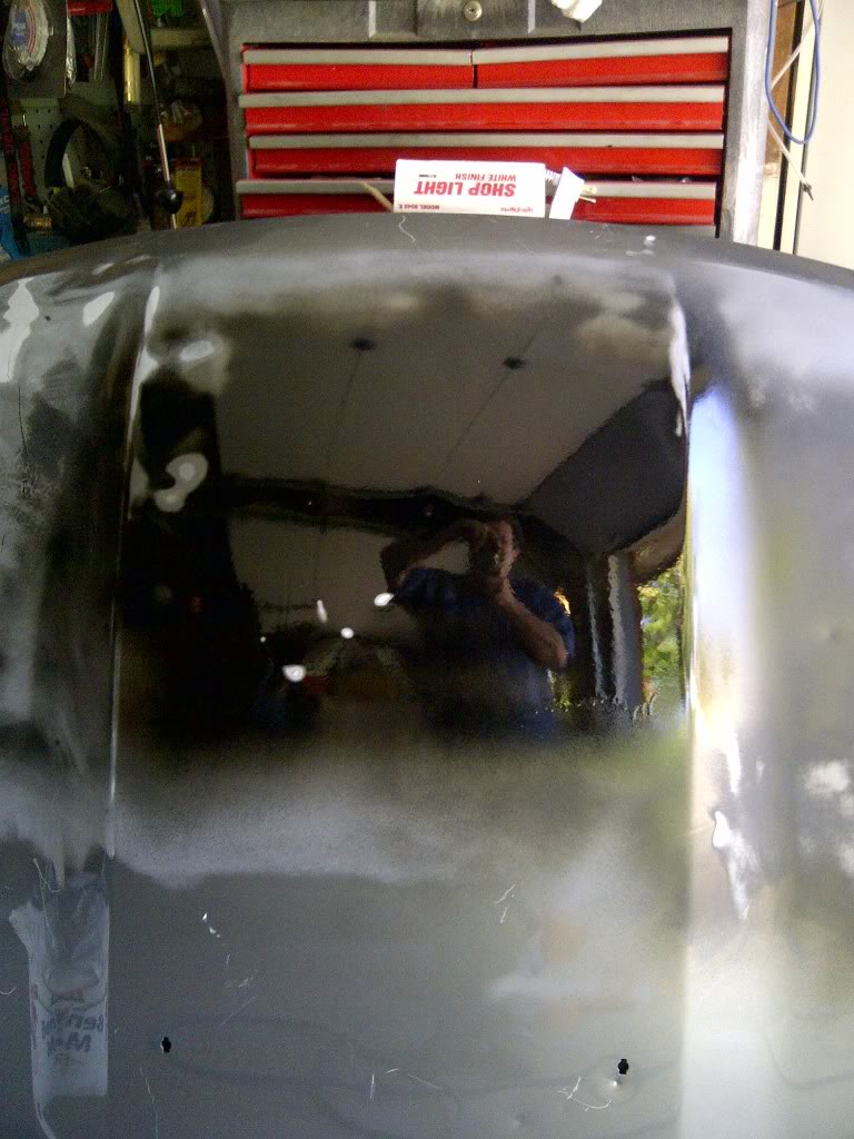

Got the hood, roof and tailgate painted. Going to give the crease in the left fender one more attempt to fix before ordering new fender. I sanded primer back off the filler and laid another thin layer of filler.
Plan to shoot clear tomorrow on parts painted today.
