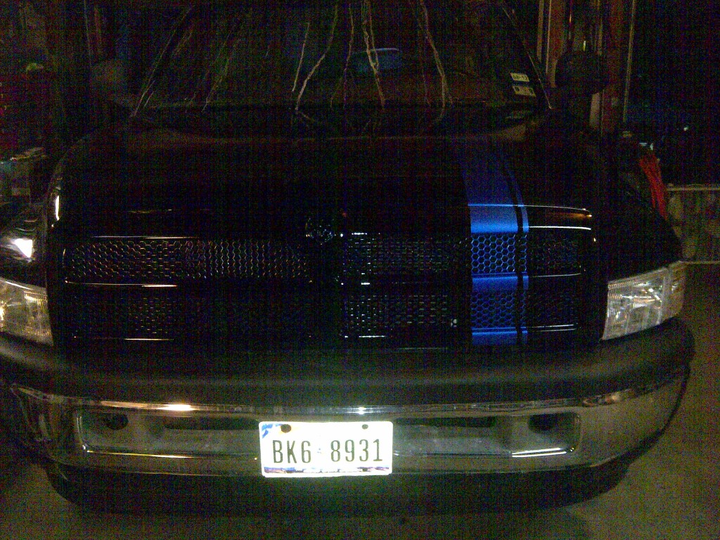

Here is the grill: (dang low light makes the photo grainy, but not wanting to drag out studio lighting...)
Kejobe was right on....a little reducer in the clear and is sprayed on very smooth. Four coats, no runs, and no orange peel. I did use a slow hardner with it also as it was 90 degrees or better today.
Now waiting on bumper and the two new bumper inserts, which will be painted black as well and then the blue stripe carried soen over the air dam. Also ordered new Ram logo for grille and new grill support. Existing suppport is not straight and have to press and pull to install. Streaightened it out some, but still sprung.

^^^ That looks so good! I'm glad I made you do it
Black bumper time, keep that stripe headed south!
