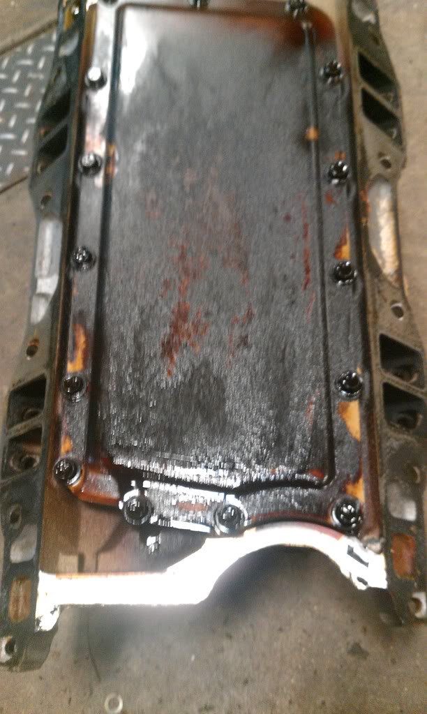

So QCL -- It's hard to tell, but did the gasket fail at the back near the dizzy? Cmon man details. Mileage? Gasket replacement? Plate replacement? Pan itself appear super clean.... Bad PCV, parking with the front end nose high? lol

The gasket doesnt really look like it failed, actaully looked like a rather fresh gasket. It does usually get parked nose high and that small pool of oil was at the back near the dizzy. Approx 210k miles on it. I just shortend the bolts and reused the pan with a felpro gasket coated in copper coating. Too bad it still has a horrible miss on number 8, even after a new head. Im afraid the truck is terminal now. Either going to trade it in, part it out, or burn it. Havent decided yet.

Ok, thanks for clarifying b/c I was like....what's wrong with that?!?! lol There was no need to shorten the bolts.
