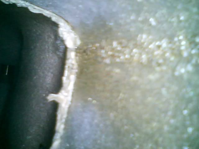

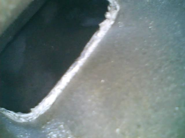

Speaking of restriction, something that's been bothering me since I installed my F1 intake, I learned, shortly after it was installed, that your not supposed to put sealant around the intake ports as it may bleed out into the intake causing a restriction, and the fuel reacts with it softening it up. My fears were confirmed today when I scoped the intake. Hard to say how much effect this has but I don't think I can expect any more performance gains till this is fixed. I may have to make time to fix this soon. Do you guys think this would have an effect on performance?
