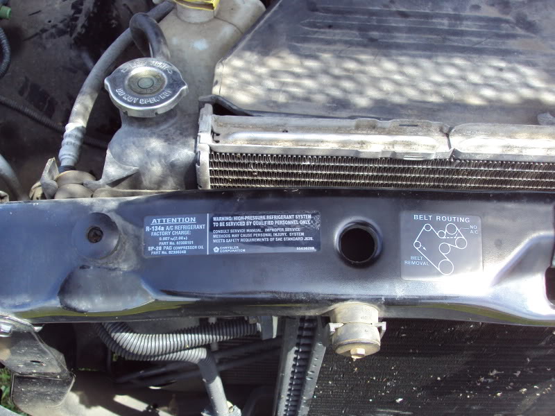

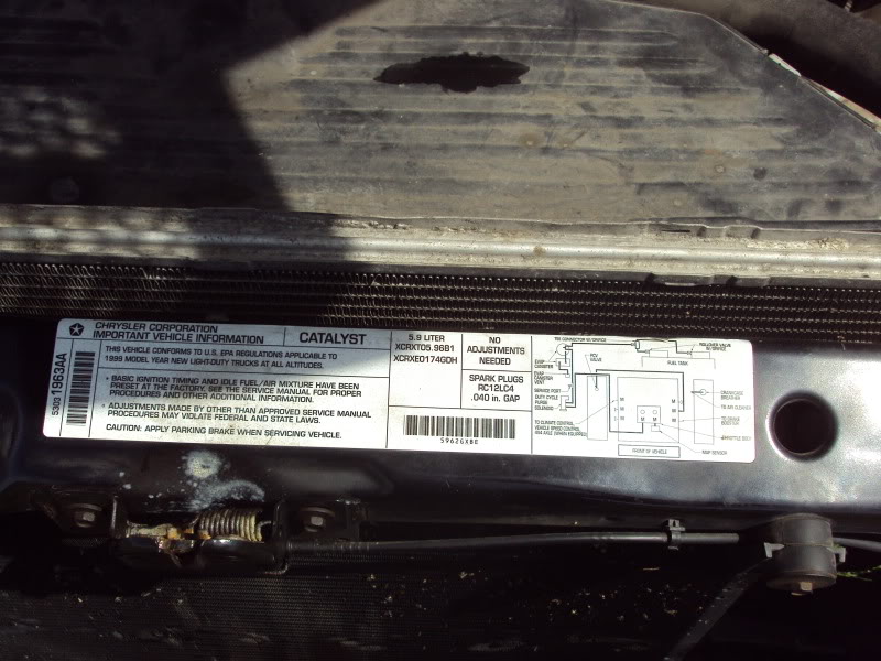

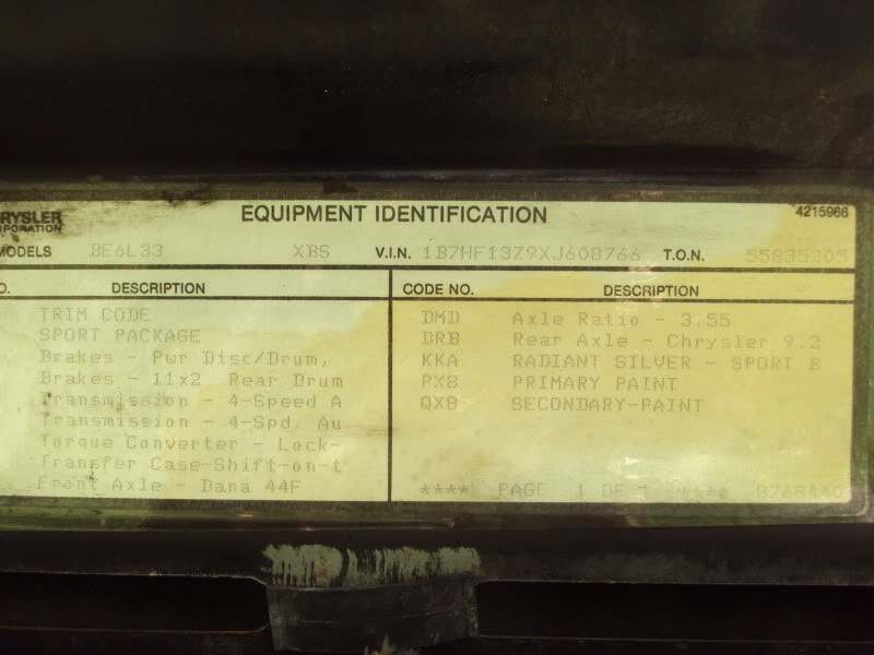

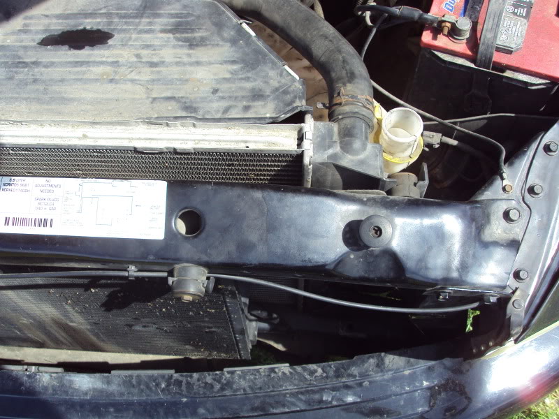

Originally Posted by zman17
. And you are sure you have no ( partial hand written) sticker on the underside of the hood or the radiator support? Give us pics, we love them.
Left,Right an center pics of core support
Only sticker,label etc on hood(
Unless they stashed it under the insulation crap)

I don't see any software update stickers...... I suppose, about the only true test, would be go to the chrysler dealer, and have 'em plug a scanner into it, and see what software revision it has. (it's isn't gonna say "death flash" though..... )
