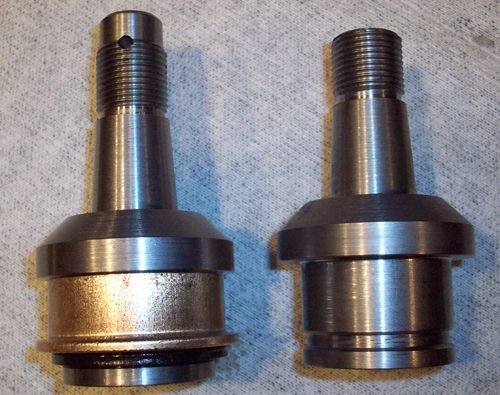

This is a ball joint you might want to think about trying. http://www.bonefishfab.com/
The Bonefish one is on the right and doesn't have wearable parts like a regular one. Check out the site and it is all explained. And if you hadn't just bought that TruTrac I could have shown you a way to install stronger gears.
Over 200 bucks to do ONE side? Holy smoke......

From: Cle Elum, WA
Yes but you only have to buy them ONCE. The bushing that you have to replace isn't that expensive. Have you looked at the price of Dynatrac's ball joints they sell? If you figure the initial expense but then only $18 for new bushings it really isn't that bad. Of course you'd have to keep the truck long enough to have to replace the ball joints. But when you're running larger tires it can be a lot sooner.
