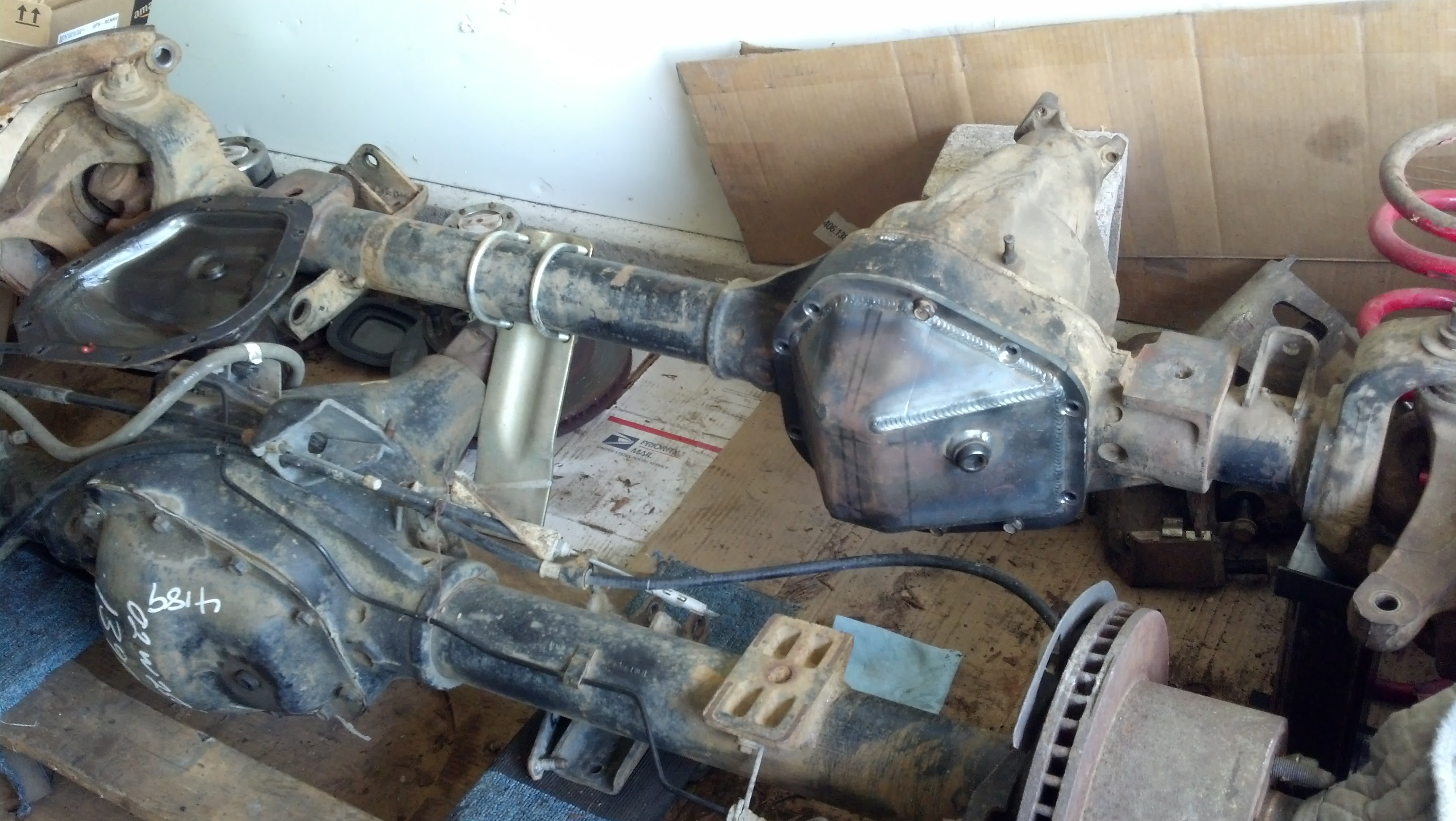

I'm still acquiring parts.
R/P for the rear D70 + master install kit and other bearing replacements.
New spring perches
1 pair of joints
master install kit for the D60
Link material for the tie rod and drag link, plus rod ends
the almighty front shocks and associated towers
ARBs already sitting here
yadda yadda
Some developments could make this as soon as end of summer or next year. Just the cards you know. But I'm doing them right as rain, plus the paint scheme. shhhhush.

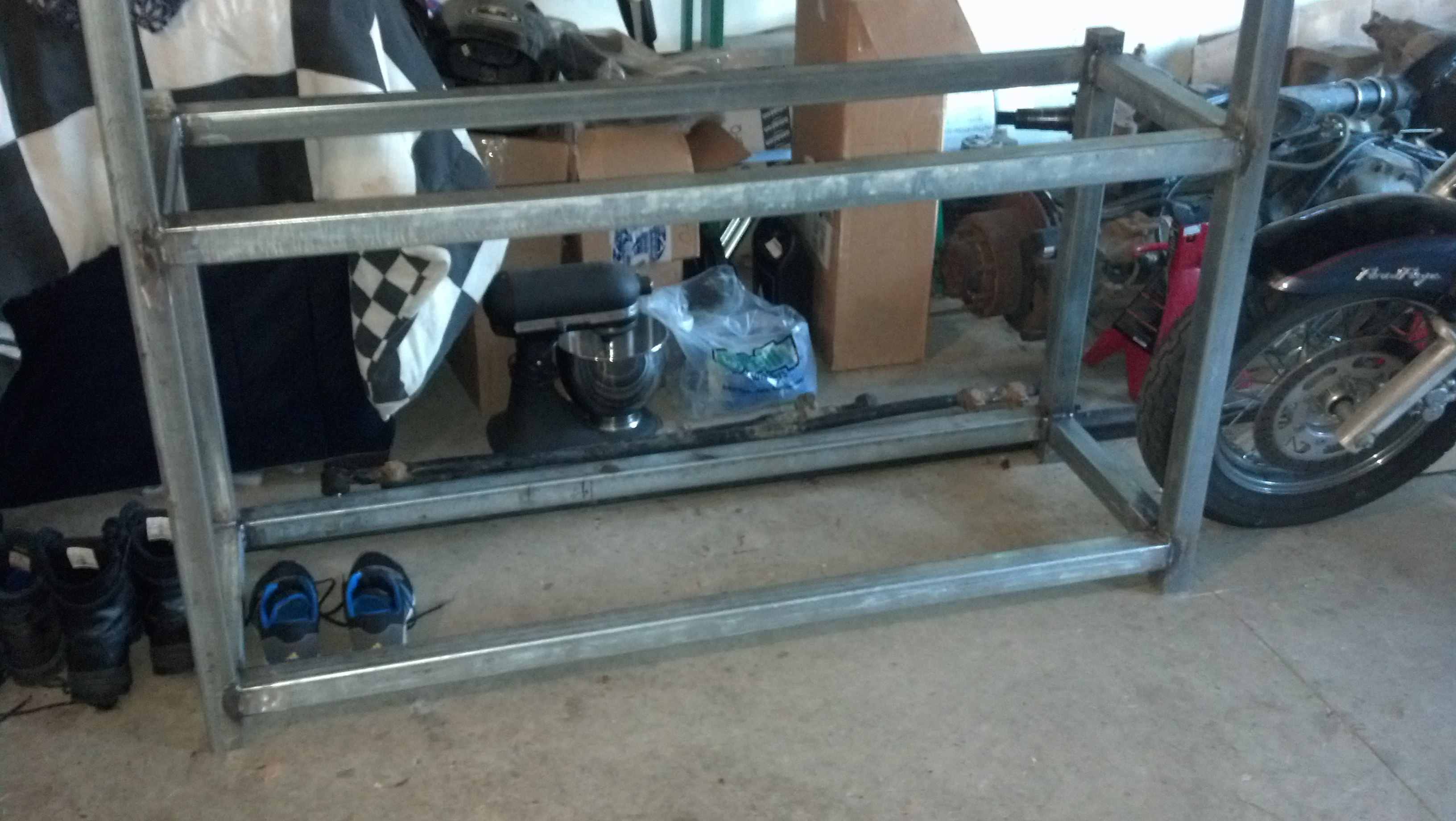

Got started on the axle stand.

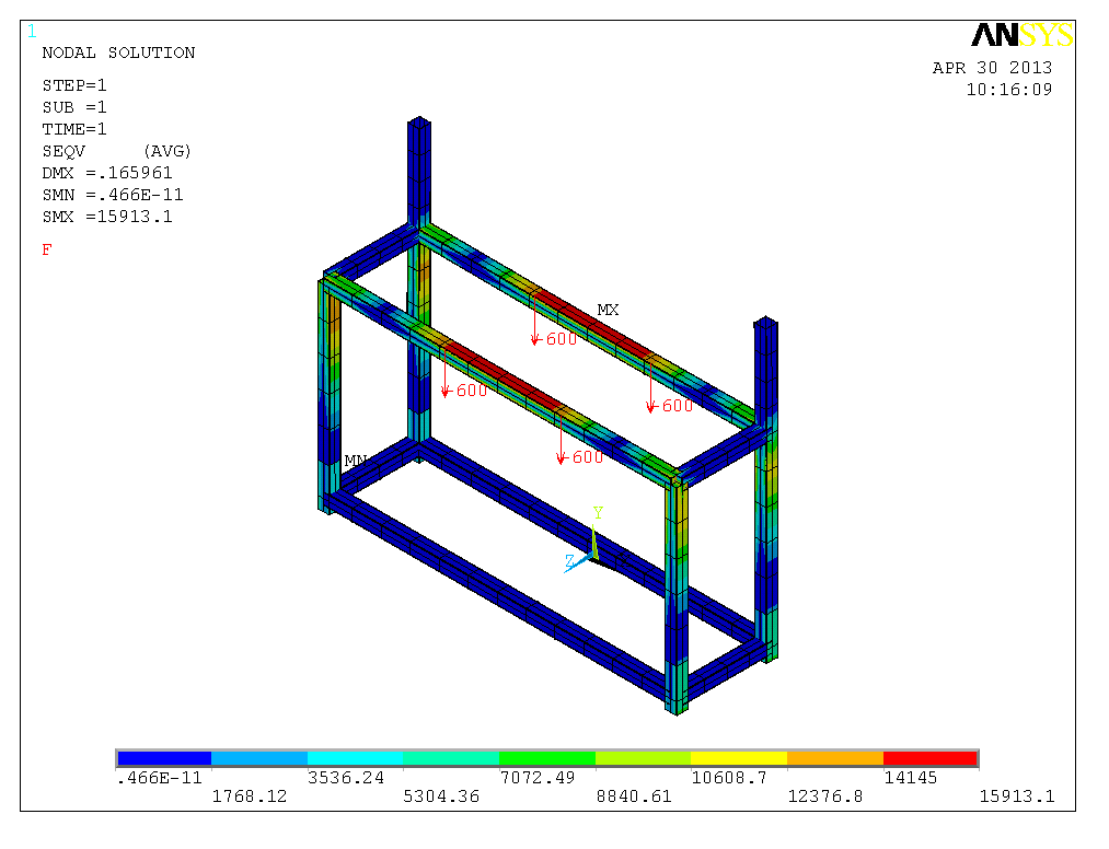

It's actually a little better than I thought. My limit will be the caster wheels I get. I think I'm gonna get 290 lb/caster ones that are step. You get a friction insert to the tube and it seats the flange very well. No welding needed.
Ella Caster Socket
Stem Caster: Friction-Grip Stem Caster W/Brake, 5" X 1-1/4" Rubber, 7/16" X 1-3/8" Stem, 290#Cap
http://www.mcmaster.com/#standard-casters/=mjwpve
Simulating 1200 lbs on the top shelf (for the heck of it) and as point loads. Single axle is roughly 500 lbs.
Deflection is just under 3/16" and roughly 16 ksi. Consider yield at 36 ksi for mild steel.
I think I'd like to make an adjustable shelf in the middle. Accomplished by sleeving solid round rod through the legs just like how a book shelf works. Something like that perhaps. Still thinking on it.
Yeah, I'll have an adjustable member for securing the pinion.

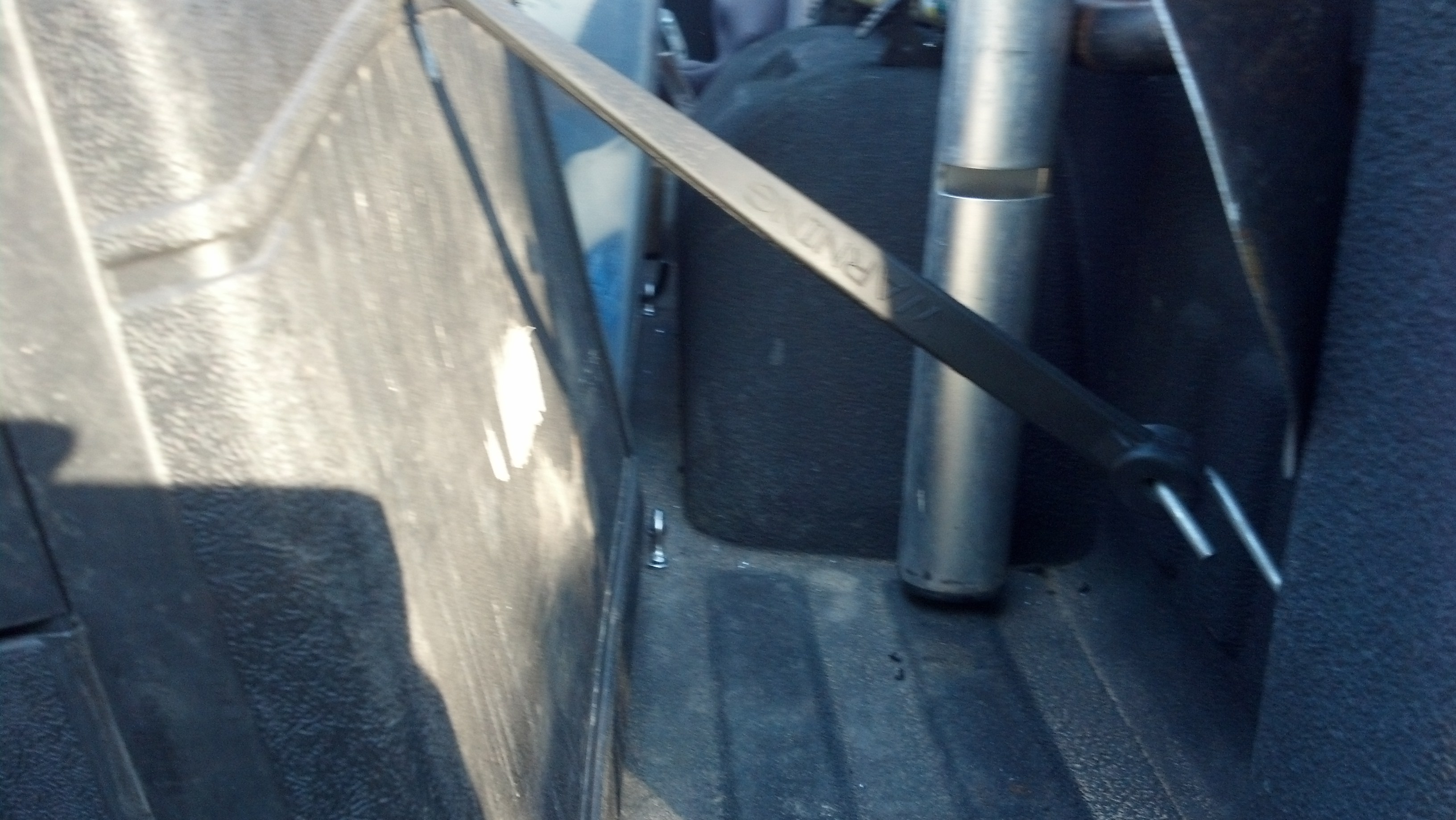

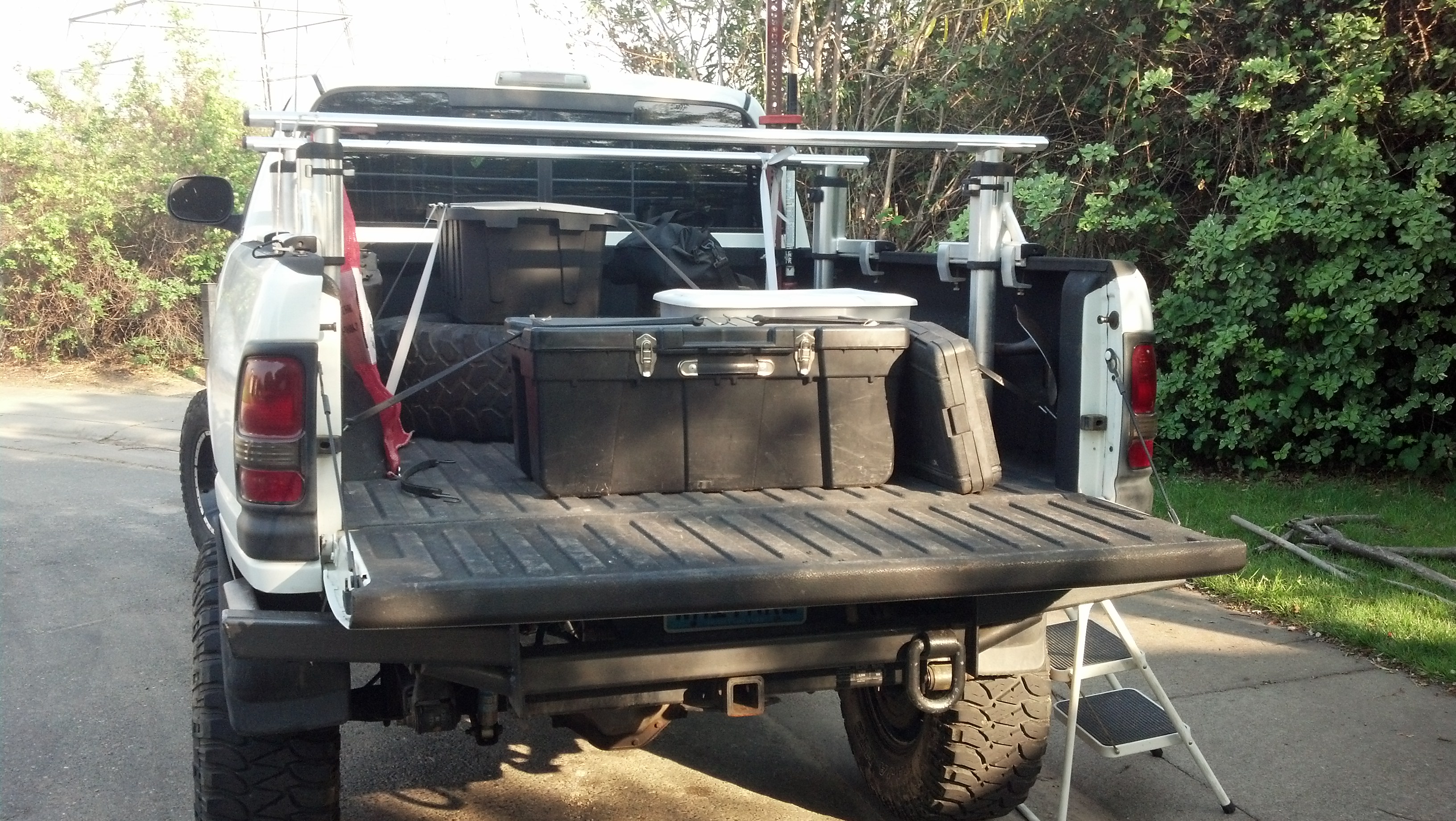

I'm all loaded up with exception of my cooler!!
Installed some proper tie down points. Used 5/8" rope stainless steel.
Yes, sway bar removed. Rides better now. I think b/c of the adjusted lower control arms and the rear shackle flip. Not so much constant correcting as before.

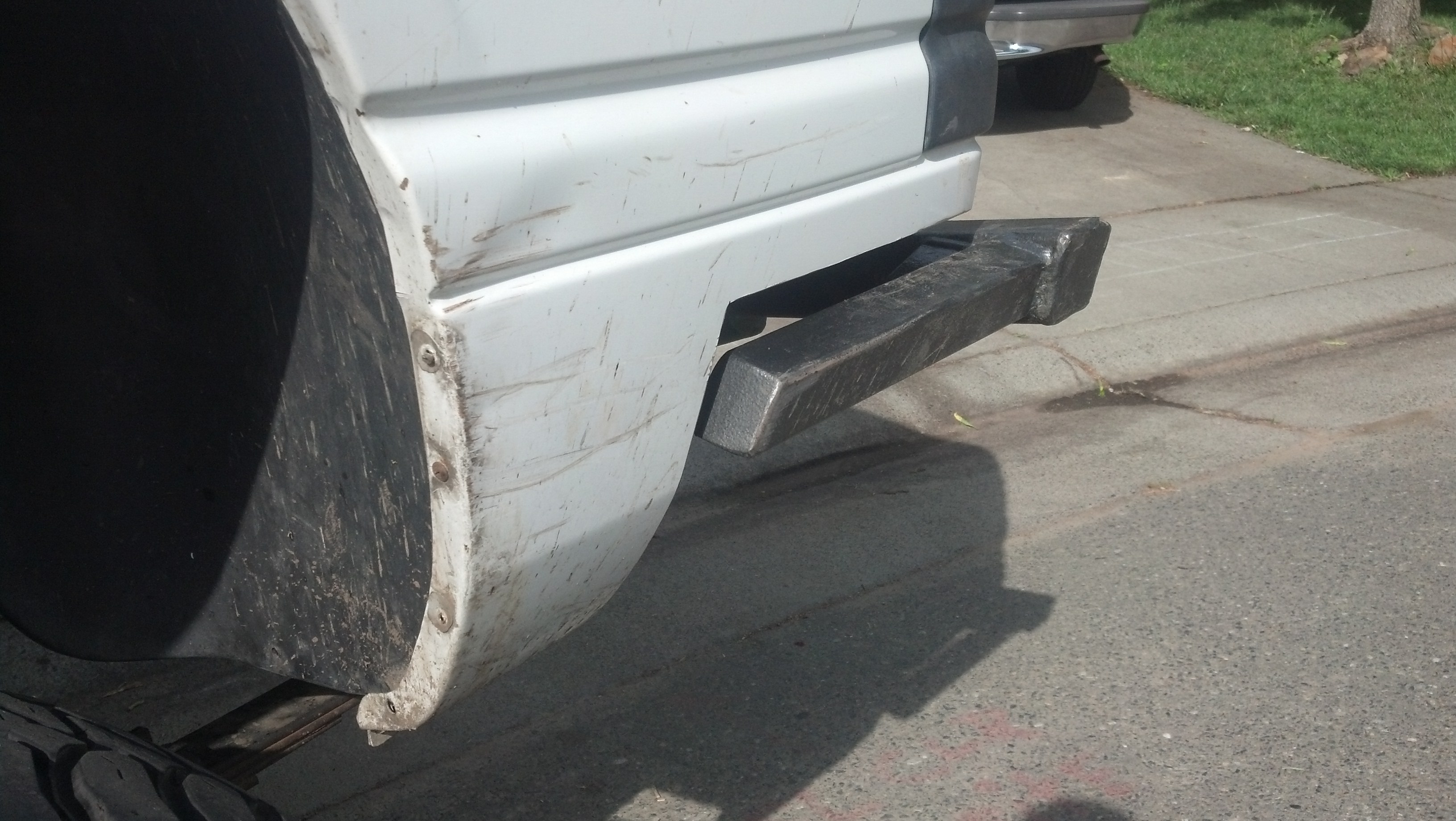

Run went great. 10 rigs in all. I got home at 1am. Definitely the most challenging I've done and I'll never do it on 35s again. lol I got my first beauty marks, badges of courage, etc.
Still checking video and only have these few pictures showing the badges.
Very tight trail on the sides and up top. Logs tried to take me out, off camber positions, water crossings, etc. Had a pucker moment of flopping in a river crossing and had to get pulled back down. One log tagged me going in, same log tagged me going out. Places I got badges are all places I already a plan for protection to be added and just didn't get around to it.
Oh well, comes with the territory.
All 10 rigs made it, no breakage, no injuries, and no one left behind.
