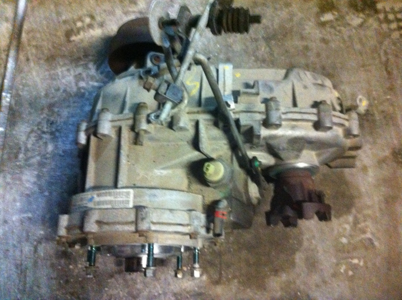

A very fortunate score today.
I will do a separate thread documenting this swap. It's going to include still using the CAD system as I don't want to toss money at a Posiloc.

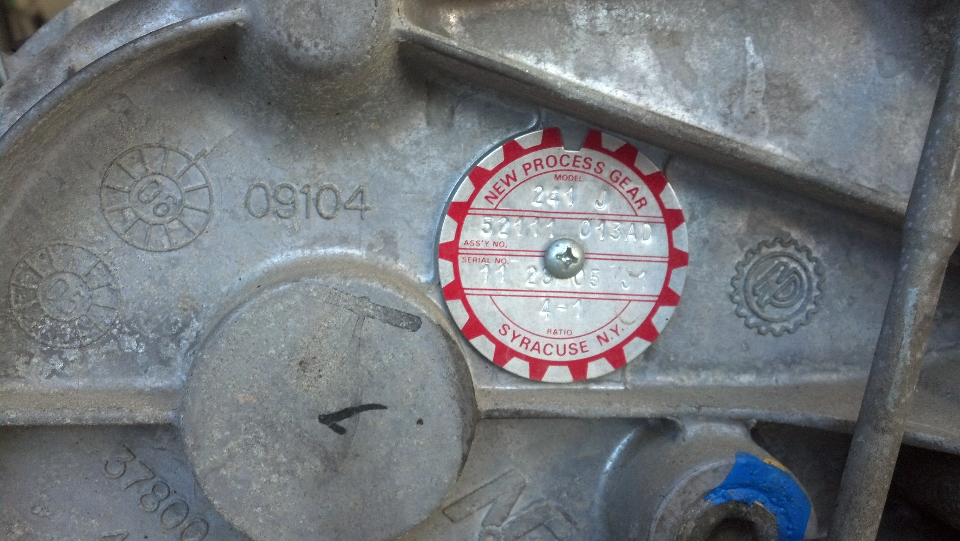

Whoa, does that say 4:1 ratio? I thought all Dodge t-cases were 2.72?
Either way nice find!

It also says 241-J.
Looks like someone found a Rubicon transfer case. A very fortunate score indeed.

Ha, good catch. I thought that read 241D. A Ruby t-case makes sense though.

I tried to say too much with too few words. Also, ReadRam wasn't aware of what parts I have being built. Let's try this again.
I already have 1 tons and lockers. They need to be geared/installed. I found someone to do it for $250 axle+parts. Just not there yet and I spotted the tcase as a real super deal. They go for $900 and up easy. Some ppl are selling for up to $1200. I got this one for much less than $800. It's definitely not an Atlas, however, it's also cheaper than a new $2100 2spd Atlas.
Since the regear was pushed back, then I want to get the tcase installed and used for the stock axles. I have no desire to add lockers to them. The Rubi tcase does not use vacuum like our awesome sauce CAD system needs. I've found a way, I think, to use a vacuum actuation switch like the following: http://www.ebay.com/bhp/s10-actuator
Just run a powered switch to it.
So that's what I was trying to get across and this switch idea may be helpful to others out there. One idea is to manually change the vac lines on the CAD everytime. I see that getting really old quick, especially out in the snow.
