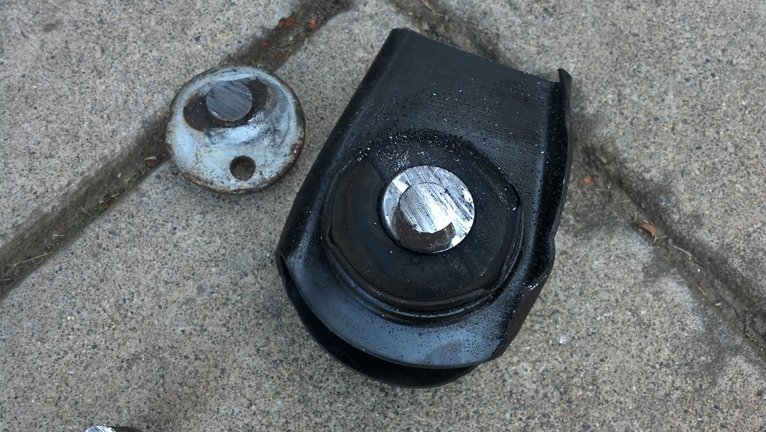

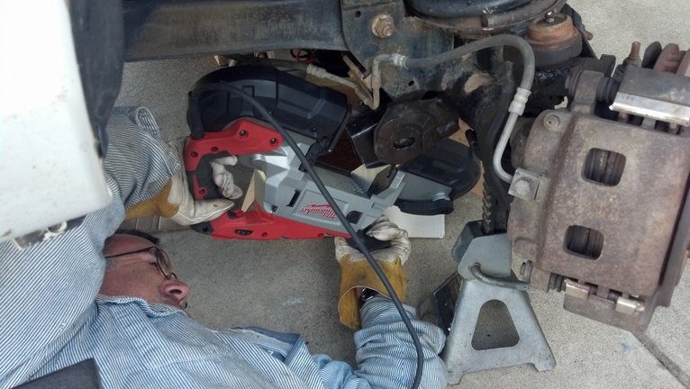

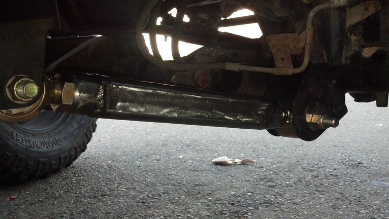

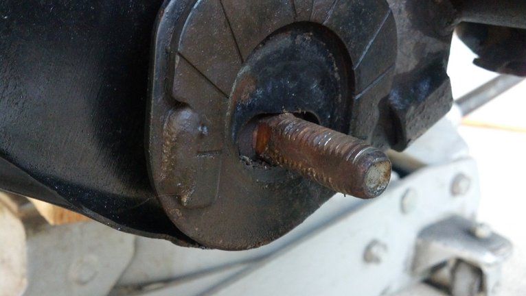

Completed the control arms.
Stubborn bolt and bushing sleeve. Bunch of you have experienced this.
Like butter

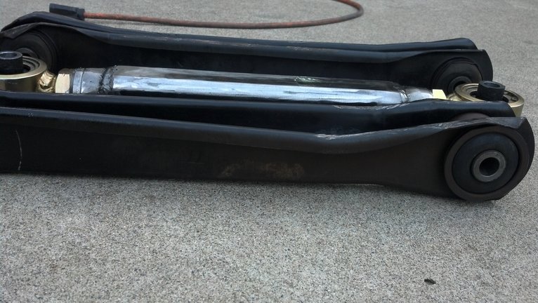

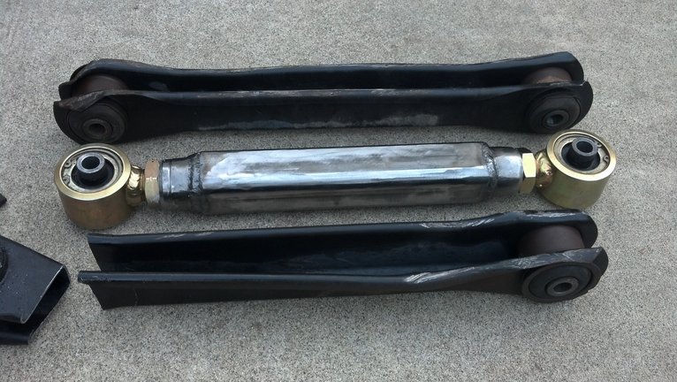

Old vs New -- How mangled

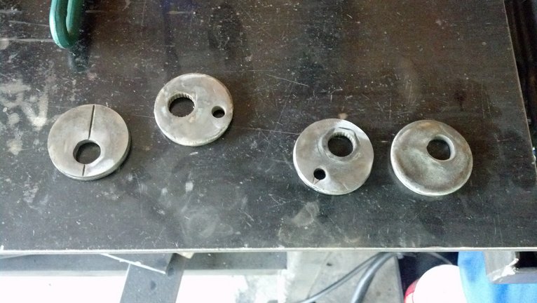

Reused the same caster washers. Just drilled out for 5/8". Those worked out great b/c they fill the space within the caster markers. On the head side you can just press off the washer using socket and vice or BFH as it's splined.
Done
