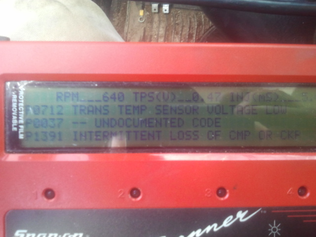

well there it is... intermittent loss of either cps or ckps.... joy joy
BINGO! At least you identified it! If only the MT 2500 could FIX it!
Check wiring back to the PCM. Got a spare PCM to swap into it?
no spare pcm, but i fixed the old ckps. wire just came out of the plug. gonna swap it out. see if it fixes it.
as of right now, it hasnt back fired anymore, but there is a WICKED dead spot at about 2500~ rpms while driving...
