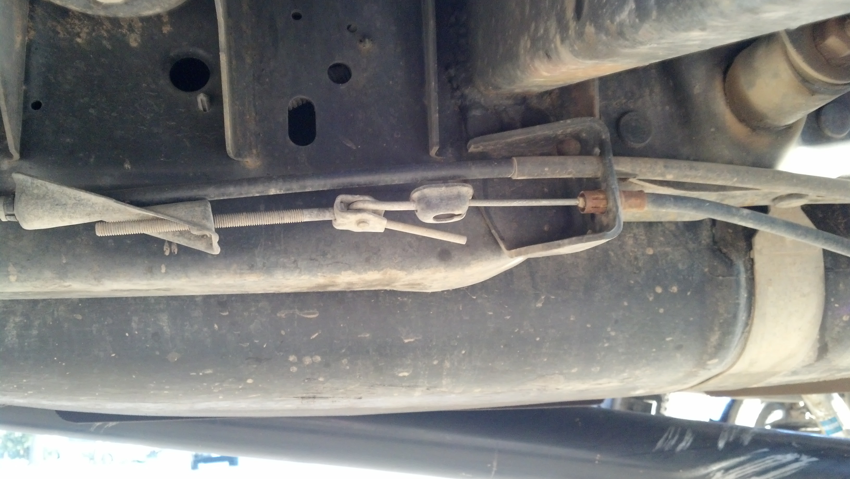

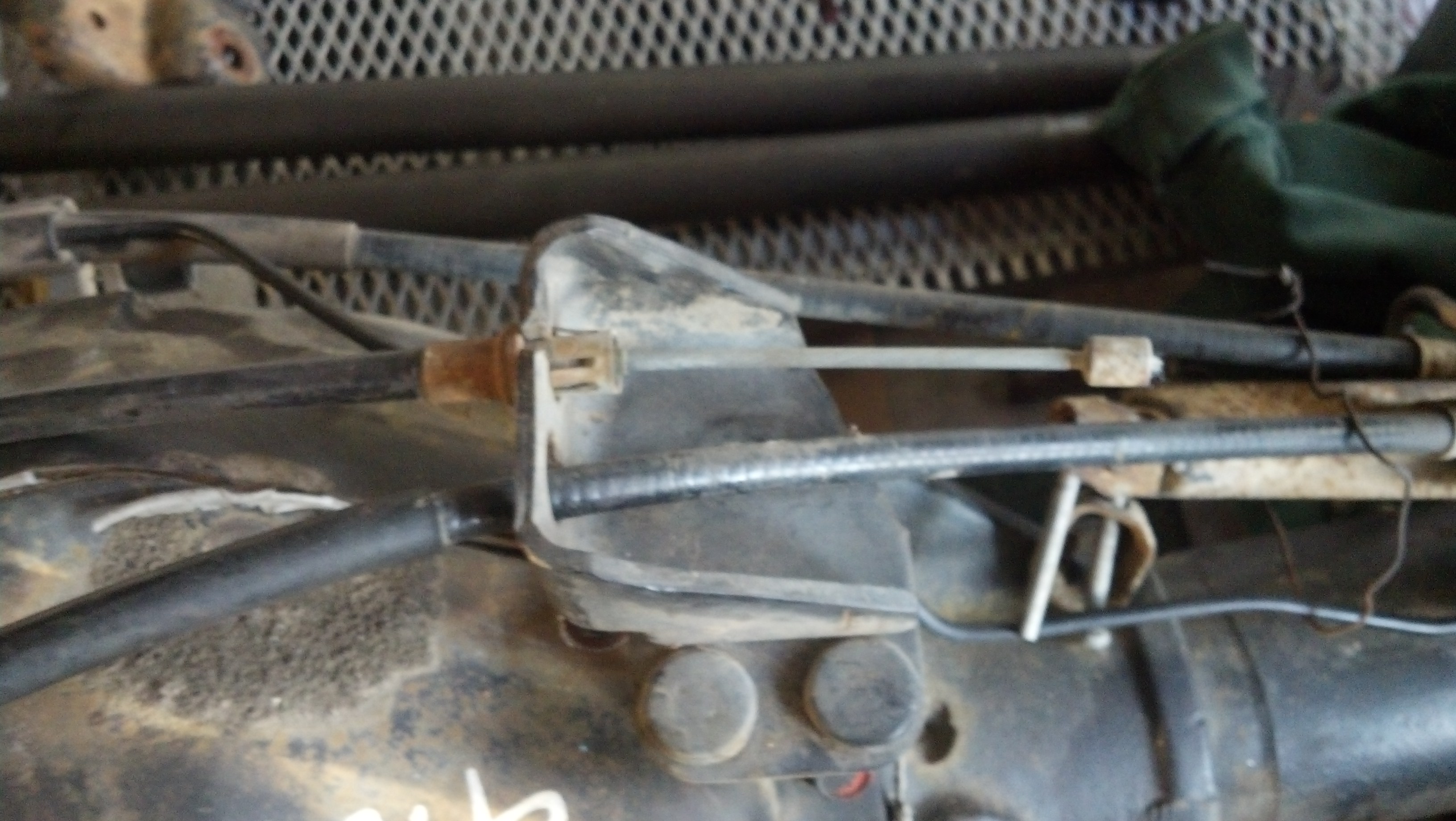

You might be missing something in b/t, but since you got the whole truck I don't see how. From what I've seen on mine it seems that it should just "hook up" hahahha You're farther ahead of me on someone else that has will hopefully confirm.
Here are my pics for the heck of it.
Disk hook up just like you said.
Cable bracket #1 to join both sides:
Cable bracket #2 and hook up to main on the pedal:
Pics for setup of the 9.25 cable just like yours..
I think you are covered.

Yea that's exactly what it looks like. I didn't know you had reae discs also? That's sweet.
Yea that's why I got the cables off the truck haha.
Those things are a b1tch to unhook
