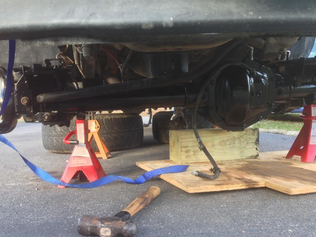

Track bar and control arms are in

Hey, call me behind the times, but, that looks a lot like a non-cad axle. What did that come out of?

That's because it is a non-cad axle. Came out of a late model 2002 2500. Second half of 2002 they switched over to no cads.
It's a big plus IMHO
