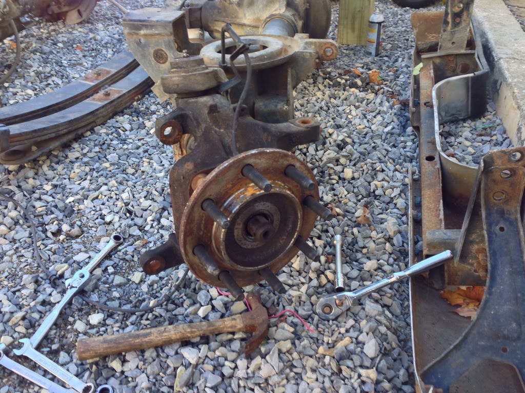

So guys, what's the trick to getting these wheel bearing off?

Sacrificial socket, and extension. Put the socket on the bolt. Only have it threaded in about half way. Use the extension so you have enough length that you can get a good swing at it, and actually expect to hit it. use a heavier hammer than pictured to whack it good and hard a couple times. Chemicals won't hurt either.

the axle nut bolt?

Yep, brute force with a 3 lb. hammer.

spindle bolt

Man, that's a 30 dollar socket

Speaking of the 3 bolts on the back side, not the axle. Mine are 14mm. 12 point. As far as I know the 60's are the same.
