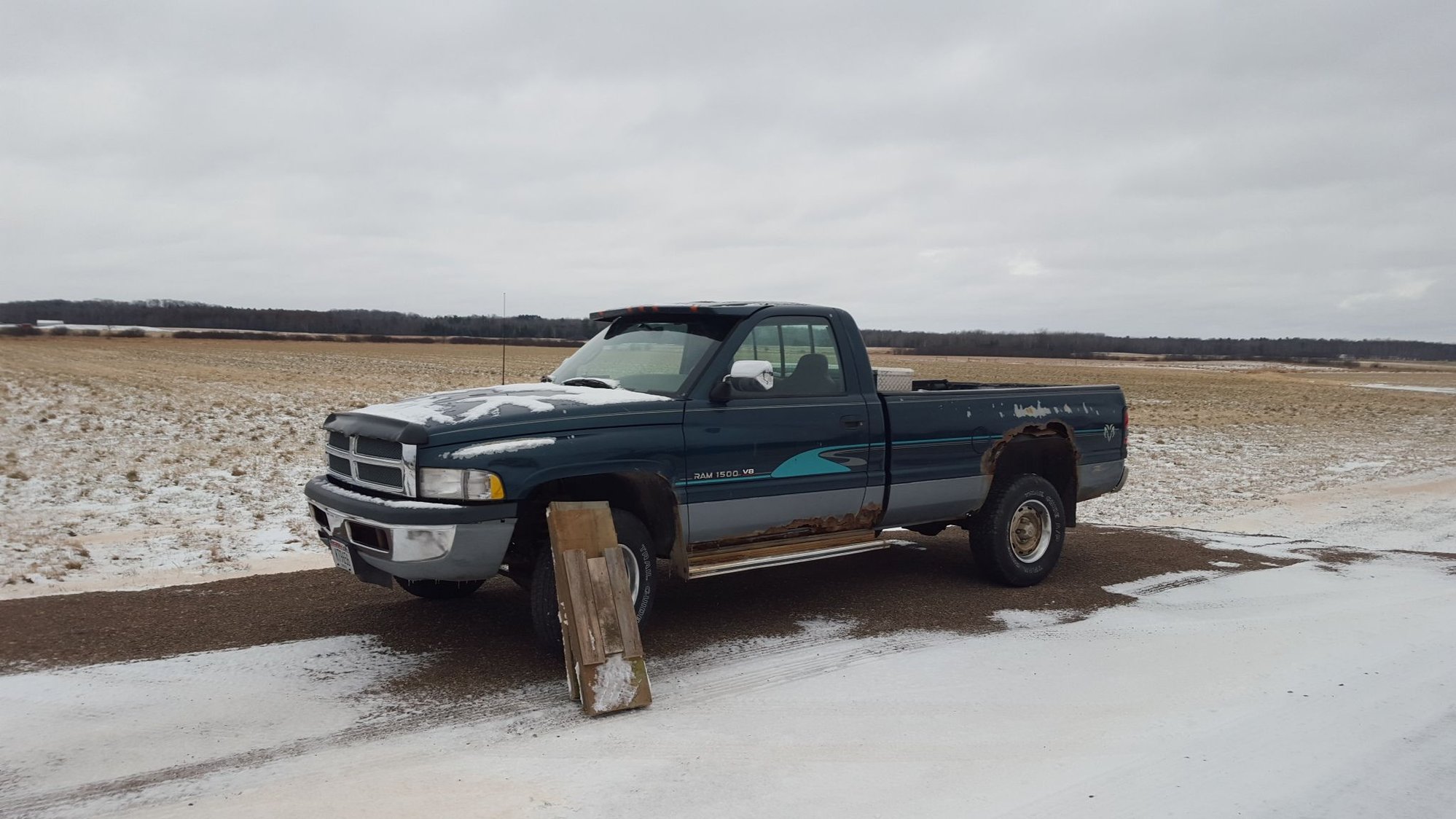

We bought a 95 1500 360 4x4 from family. We're not sure how far we're going to go with the fixing. It has sentimental value, so for now we're getting it to where it's safe to drive. We bought it in 2014. So far we've replaced plugs, cap rotor, wires, track bar, power steering pump, front brakes, calipers, rotors, gas tank straps, fan belt, tensioner pulley, and a few things I'm not remembering. It was running well and handling decent. The transfer case wasn't working properly, the rear tires would spin, make a big bang as it tried to engage the front axle. I put the kit on the axle disconnect to keep it locked, thinking that was the problem. Must be in the tcase as that didn't fix it. Then the transmission went out. So it's pretty much been sitting around since then. The forward gears still kinda work so I've used it a few times.
That brings us to buying a used tcase last week and ordering a tranny from Carquest today
Attached Thumbnails 95 Oxidizer Special-20151228_152258.jpg   95 Oxidizer Special-20151228_152239.jpg   95 Oxidizer Special-20151228_152227.jpg   95 Oxidizer Special-img_20140711_195231.jpg

It runs pretty good. Looking to the future, I guess I'll probably start with the kegger mod, new plenum gasket, clean/ replace IAC. It needs shocks and sway bar links also. One of the rear brakes has the line pinched off, so brake lines, drums, shoes, and wheel cylinders. Actually start with brakes first.
We put 265 tires from our Excursion on it and put new ones on the EX, so it has fairly decent tires. I got started doing bodywork on my daughter's 87 Chevy and kind of like it. So I may cut out the rockers and weld in some new ones. Then try to accumulate parts from there. ???
