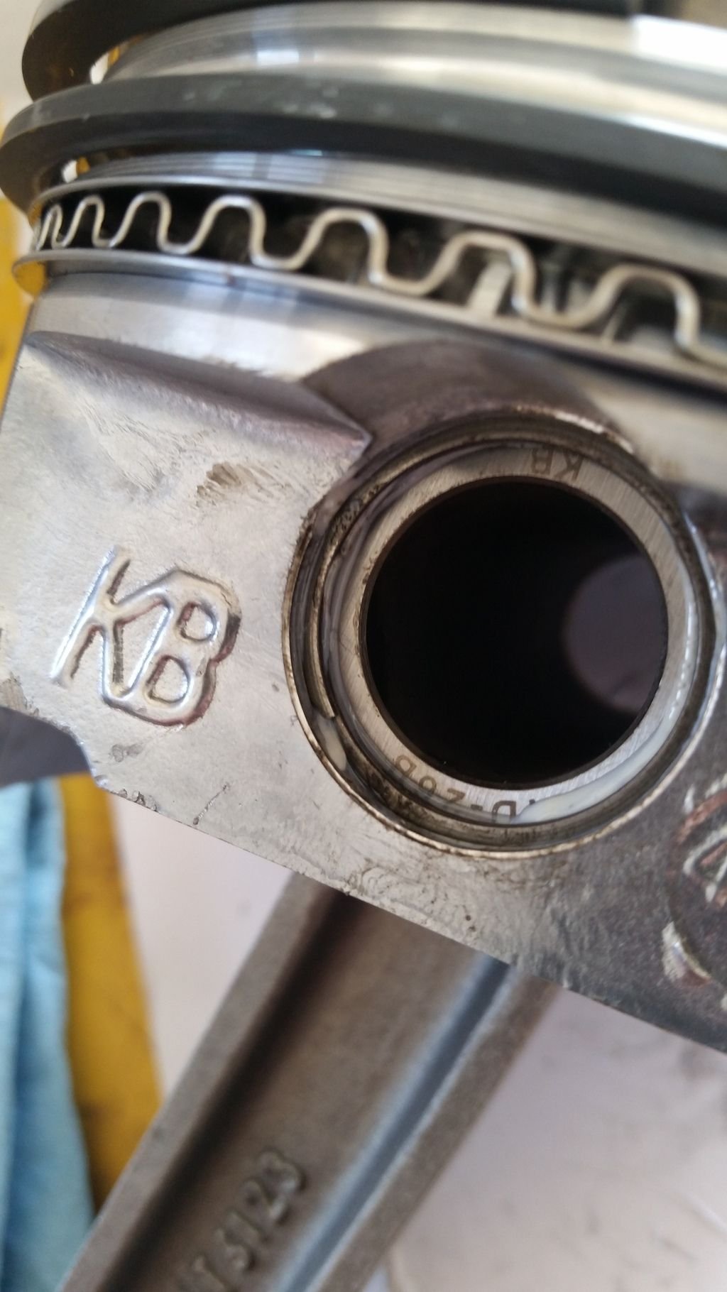

Well, I've made a little progress on this thing.
Lock ring install guide.
Just waiting for the second lock ring.
These things are a pain to install!!!
Another view of the lock ring.
Installed.
All ready to go in.
Good stuff!
Getting ready.
Balance sheet for the crank.
Crank waiting for the other goodies.
Heavy metal for balancing. #5 main cap behind it.
Forward most counter weight. More heavy metal.
Measuring oil pan depth to set the pickup tube. 8.75" deep.
Setting the pick up tube. 8.5"
I also got the cam and timing set installed today. I'll get some pictures up tomorrow.
