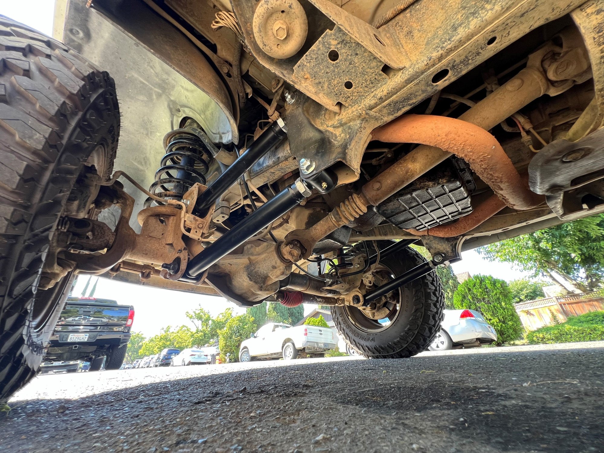

I got my Stryker Off Road Design adjustable control arms put in. Really nothing spectacular but they are extremely beefy.

Those look nice. And yeah, rather beefy.
Does your front driveshaft hit the crossover pipe when the suspension is at odd angles??
