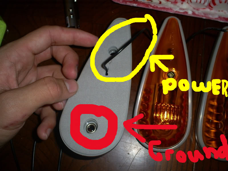

were no directions. And there is only wire that is connected to the light.. the black one

Originally Posted by dodgeram07
black is power(werid) and the srew that goes in the roof is the ground... tyr gounding the srew and power on the black and see if it works.
this help?

I installed them today. They look good and ill get pics up tomorrow. One question though.. how do i wire my lights in with my headlights? i dont want to have to flip an extra switch to turn them on.

Originally Posted by vmann
way in over my head... my ***.
Connect the parking light 12v (+) wire to the power source for your lights. It's as easy as that. Did you use a relay for your lights?
i dont know where the parking light wire is and i did not use a relay. I ran a wire from my battery to my switch (with a fuse on the wire.. came with lights) and i also connected my lights directly to the switch. diagrams, pictures, links would be appriciated. thanks
To use the running lights as a switch, you need to either look up the color of the wire or use a diagnostic tool such as a DMM or test light to determine the wire you need. You can then tap into that wire for power. This will replace the wire that you ran from your battery to your switch and will give power to your cab lights when the parking lights are turned on.
