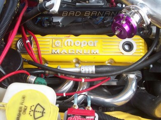

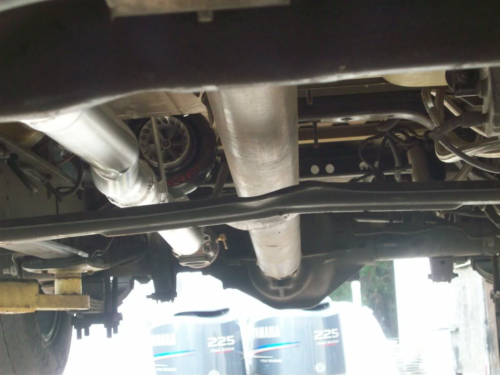

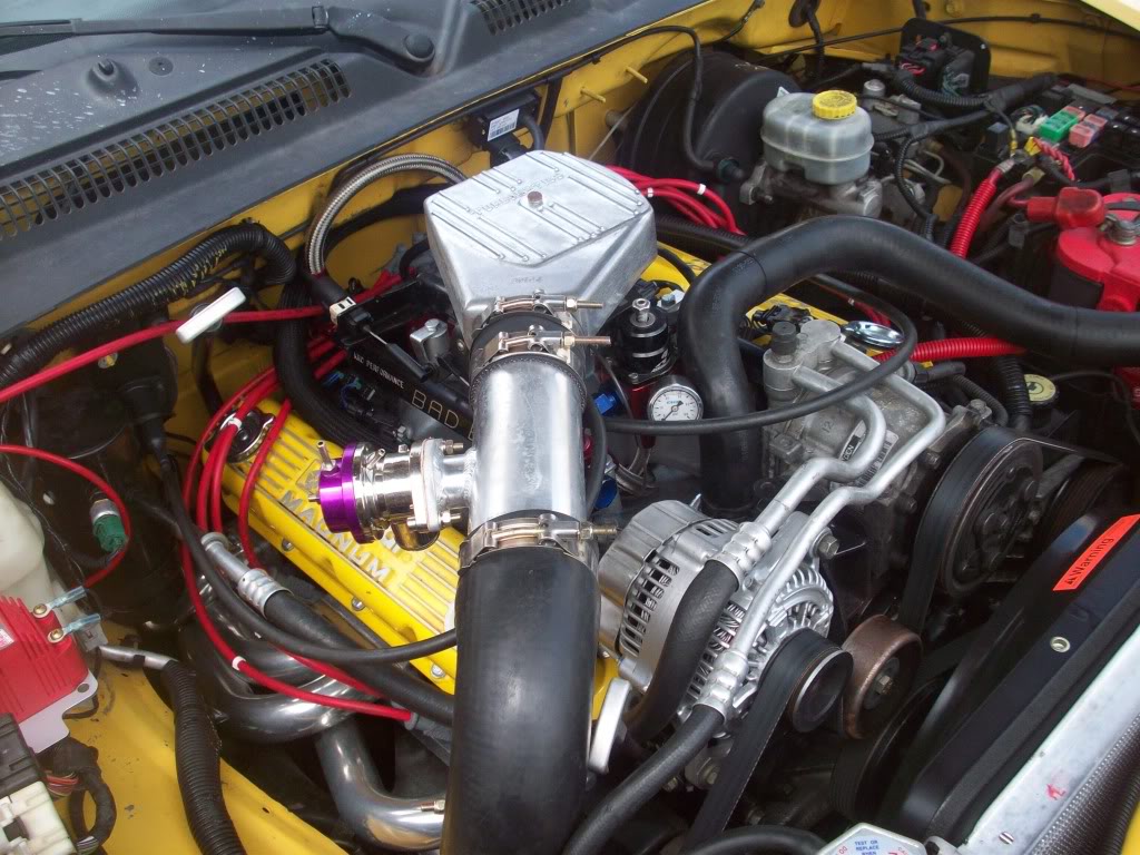

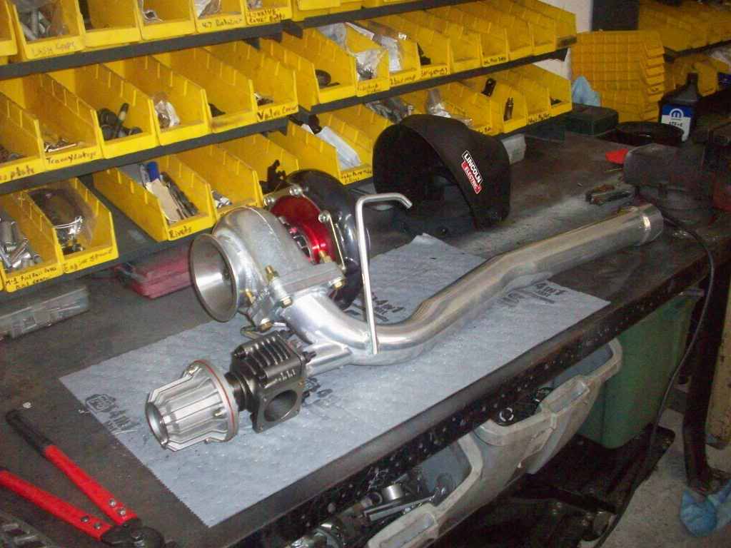

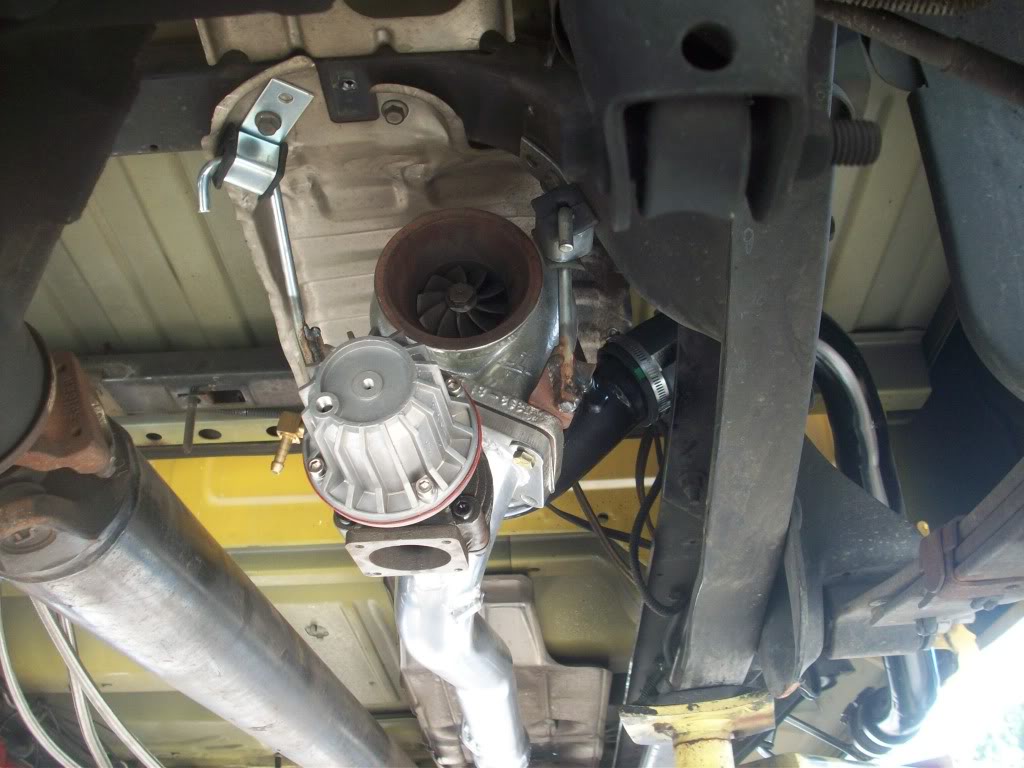

<-- running a krc sts kit.
$2600 gives you a full kit with all parts, upgraded injectors, and sct tuning.
They have a twin turbo kit for an additional 1k.
The reason for a rear mount, well you don't have to have custom headers made, and the length of pipe under the truck and the air flow, helps cool the return charge, acting similar to an intercooler. As for lag, I am running an .81mm gtk-850 turbo on a 408 with 8:2 compression and am getting into boost @ 3200.
There is a boost thread (sticky) under the dakota section. If you need any more info on the subject, lemme know
