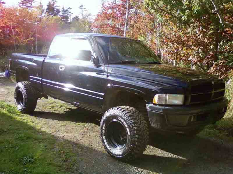

This is my rig , she is getting a suspension lift in the near future ..now has 3" body lift. I did the body work myself (first attempt) welded in cab corners,rockers,box panels...and i learned most of it on an autobody forum ! Similar to the way i'm learmning about engines right now on this forum.
