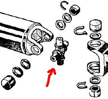

ok so we are talking about this thing.....
Can I change this myself? Do I need any special tools? And should I replace anything else while im in there? and do i need to do both sides at the same time?

that is a u-joint but the pic shows what looks like a rear drive shaft, you need the u-joint for the axle shaft inside the front axle, can be done your self, pull the tire&wheel, brake caliper, and wheel bearing, then the shaft will come out, but better have a torch handy to get it apart
