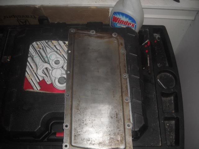

Purpl, did you get that thing drilled and sanded yet?

All the holes are drilled out. Just need to take it to my uncle's and give it a spin on the bench grinder.

be careful with that bench grinder so you don't dig a groove into the gasket surface. those things are powerful and it would be easy for that thing to get away from you.
wait a minute, bench grinder? your uncle is gonna whip your behind when he finds out you put aluminum on that thing. aluminum cakes into the stone on bench grinders, you need to use a belt sander.
Damn, thats how much I know!!! Dremel will work fine.

Yep, it will. I love my dremel, I use it quite a bit. just use the cylinder sanding bit with the removable sanding cylinders that is about 1/2" in diameter. I think that sanding bit comes standard with all dremels.

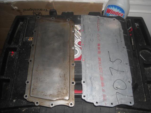

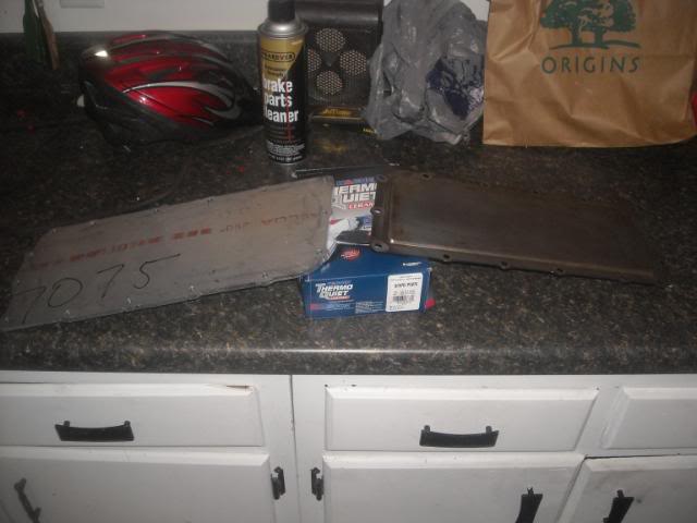

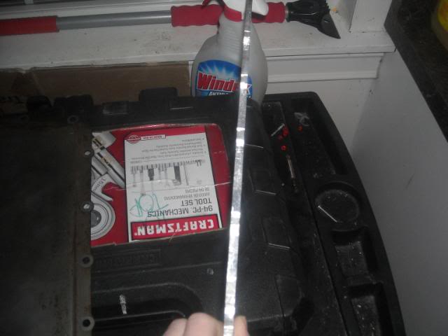

Here are some more pics:

Some 400 grit sandpaper and you would not be able to tell mine from a Hughes or APS plate.

Looks good , so now how much $$ do you have in everything to make the plenum....sheet of aluminum, blades, grinding discs or sanding ones, hardware for the plenum + gasket, and how many hr's you got logged in on making it? Did you get up to or over the $86 dollars for a hughes kit? Be truthful , not gonna say told you so , or you shoulda just got the hughes kit,( im sure you'll get that anyways) I'm all for you making it yourself , because its looks rather simple if you take your time.

Damn jr you're doin good so far, my only question is looking at the orginal plate, does the new one need to be recessed in the middle just as the orignal was ?
$12 for gasket
$9 for jigsaw blades
$5 for Dremel grinding wheel
+_____________________________
$26
Pretty amazing, huh? The aluminum was free.
I've got less than 2 hours in the plate.
