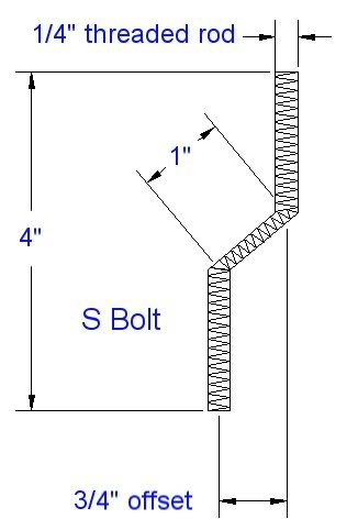

here is the other way to mount the 14x3

truegent- That is how the majority of us made a connector rod, and that is how I would do it, less restriction and just as effective as the Dakota stud.
