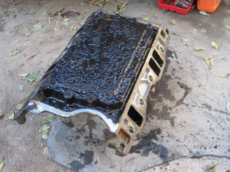

So as I was doing the Plenum on the Ram, I noticed a "rod" was out of place. I'm not much of a dodge person but thanks to this forum, I know what I'm doing; thanks!
Ok, now to business. When I removed the plenum I noticed this "rod" (not really sure what it is) was out of place. What happen? is there a possibility that a valve is bent? How would I fix this problem? Also, what can I use to clean all the smudge?
these are some piks I took:

That is a push rod, and you have some big issues there. Maybe you can replace it , and that lifter and get lucky. That is one nasty/dirty looking valve train.
Edit, For that to happen, a bad lifter or broken valve spring. Remove the VC and check it out.

Cleaning that is going to be a chore..... what I would suggest..... Is to use some variety of heavy chemical degreaser, after removing the oil pan, and pump..... You really dont want to wash it all into the oil pan, and leave it there........ You are going to want to pull your valve covers too, as I bet they look pretty much the same.

wow. that's bad. did this engine run? i bet not worth a ****.
how many miles on that engine?
as zman said, you have a push rod out of place, which means that one valve has not been opening and closing. i think that's an intake valve?? but it doesn't really matter - you HAVE to fix it.
first things first - find out what all is wrong before investing any more in it.
pull the valve cover on that side. remove all the spark plugs. inspect the valve train on that side and rotate the engine and see what's wrong. ...hope that your not pulling the head next....
next i would do a compression check to determine whether the motor is worth saving or not.
if you can save it, then do so.
to clean up the sludge mess, like Hey said, drain the oil and remove the oil pan, oil pump and filter and put a BIG rubbermaid or something under the engine - then (DO NOT SMOKE) pour diesel fuel or kerosene or gas into the lifter valley and swab it around with a paint brush. rinse it all down through the block. do the same with the valve train.
clean the bottom end up including oil pan, replace oil pump. i bet it will run a lot better than it used to. if it does, consider using some engine flush to clean up the all the places you couldn't swab out, including timing chain area. follow the directions and change the oil again afterwards.
