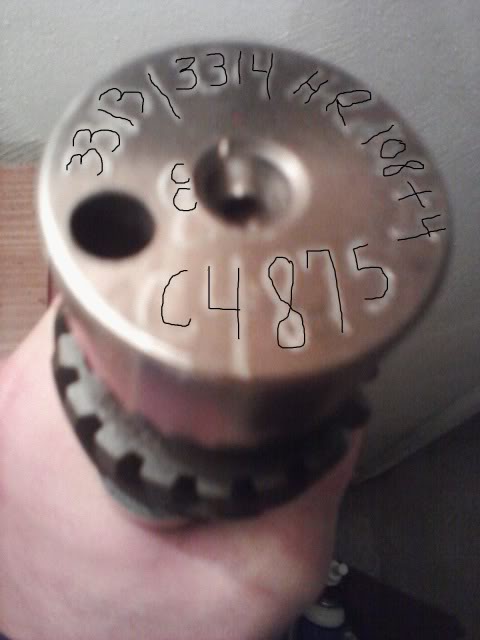

ok lots of different numbers on this cam including some hand etched numbers on the rear end. does that indicate a custom grind? on the rear end: C4875 (BIG LETTERS) THEN cc written above that and at the top 3313/3314 H-R 108 +4

heres a pic. i outlined the numbers
they are etched in by hand

I think thats a comp cams cam? Try calling their service line:
1-800-999-0853
I suspect the +4 implies the cam is ground with 4 degrees advance right from the factory.... installing it 4 degrees advanced with the timing set as well will give you a total of 8 degrees..... Might have some odd performance issues that way.

yea thats what i was thinking "cc" stood for... i tried finding the cam card on their site but it didnt pull anything up for c4875. guess ill call em mon.

I found one with some of the same numbers.... but, it was for a chevy small block. Somehow, I don't think that's it.

mite it be a custom grind?

Entirely possible. Probably have to chat with 'em to see. Would explain why it won't come up in a search of the site.........

There ars some chevy grinds that will work with a dodge.
