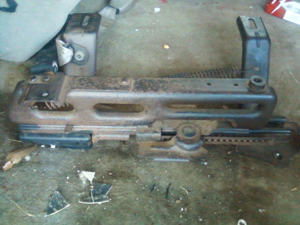

K, here is the pic of the bracket I am trying to remove.

Slide the rail forward. Just tug on the release, and if it doesn't move on its own, give it a push. That should give you access to the cover, and the bolt under it.

Yea i'm going to try that now. Wasn't nothing under the heat sheild except a thick rubber peice which dosent come off. I'm going to have to grease the rails first because the truck been sittin so long its jammed or something.

Broke out the grease gun and greased it up, got it to slide back so I was able to get to the retaing bolts (well actually it was two phillip head screws, lol). Thank you for your knowledge, I've done been messing with it for two days and your input worked and saved me a headache.
