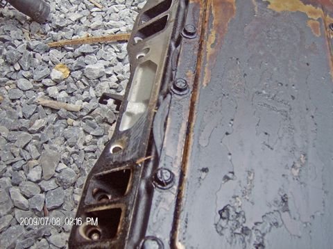

Newbie Dodge owner, here. My wife and I bought a ‘98 1500 with the 318. I’ve had two Jeep Cherokees and currently DD a Liberty. Oil leaks are not new to me
Anyways, we have had this truck for a little over a month, now, and we’ve put about 2200 miles on it. It drinks oil. I looked down the TB and sure enough, I can see oil in the intake.
I see the Hughes plenum kit, but I also see the Mancini Racing kit. Are they essentially the same thing with a $20 difference?
Also, what else can/should be addressed while the intake is off? Stat? Anything else? I plan on trimming the runners a little bit. The truck has 93k miles on it.
Thanks

In all reality, you don't need a replacement plate, that really isn't the problem. A GOOD gasket, and shorter bolts, (or washers under the existing bolts) will be adequate to the task to solve the problem. Doing the thermostat at the same time certainly won't hurt anything. Might consider doing the timing chain and gears at the same time..... It's only six or eight more bolts, and the timing cover/waterpump come off, and the gears are right there. Stock is a morse style chain, which are notorious for stretching.... I installed one of the SK? double roller fellers, and was amazed at how much pep the motor picked up......
Thanks for the info. If that’s all that is needed, I’ll go the cheaper route, especially since this isn’t a primary vehicle. Stat will definitely get changed, as it seems it has a “cold” stat, right now. The temp gauge rarely passes the 10:30-10:45 position.
From some of the pics I seen the gasket moves and that let's the oil in. Even with a better gasket the stock plate is thin and it still could move. Didn't the factory or somebody come out with a "improved" gasket? You can find the plate on ebay also. I was going to get a plate of 1/4 aluminum and make one but the size of the plate I needed to buy was close to the cost of the Hughes kit.
