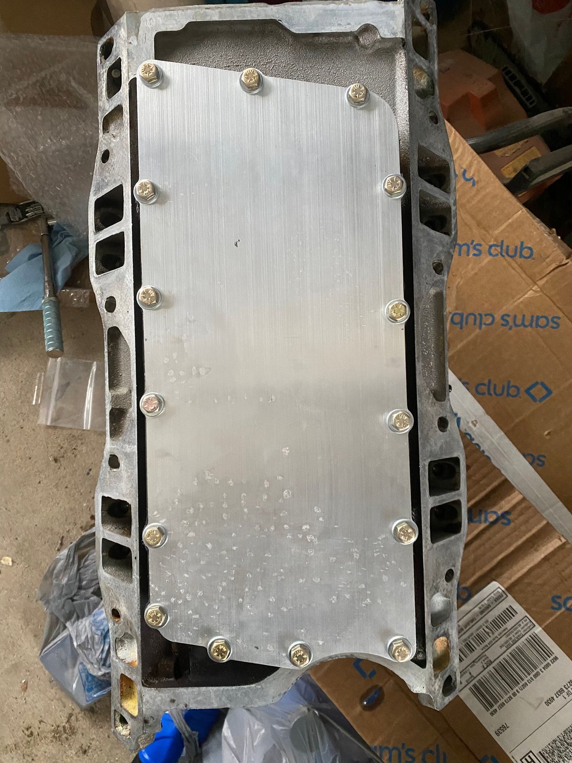

I know I ordered my Plenum plate from eBay as it was cheaper than Hughes and it arrived within 2 days during black friday.
they had the plate out the door on Monday, it was usps who dropped the ball. After pricing fasteners all the way around and gasket set then the shipping for things other than the fasteners I just decided for simplicity To go with Hughes. The Hughes felpro kit, best I understand is felpro TTY fasteners as well. After using felpro vs other brands for ford small block intakes in the past I like the felpro gaskets. They go in easy, don’t slip around and come off clean if you ever have to re do the job. Really nice when using them with FSB head gaskets. I know they cost more money but when there is peace of mind in the gaskets as well as meticulous cleaning and work to install, it just makes me feel better at the end of the repair.
But on a good note it does appear my plenum plate made it to my regional Distribution center this afternoon which means a good chance it will be here tomorrow after all!

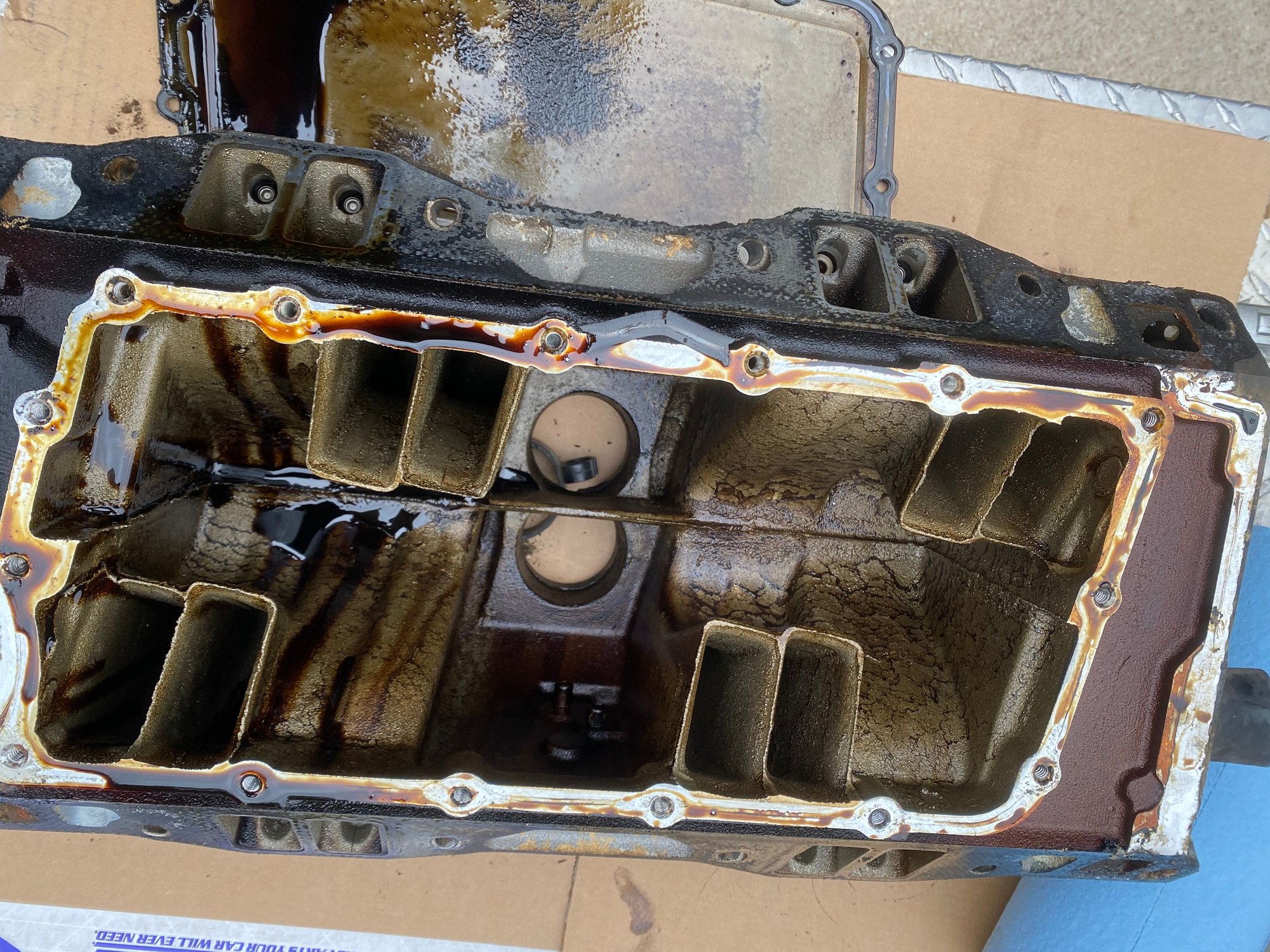

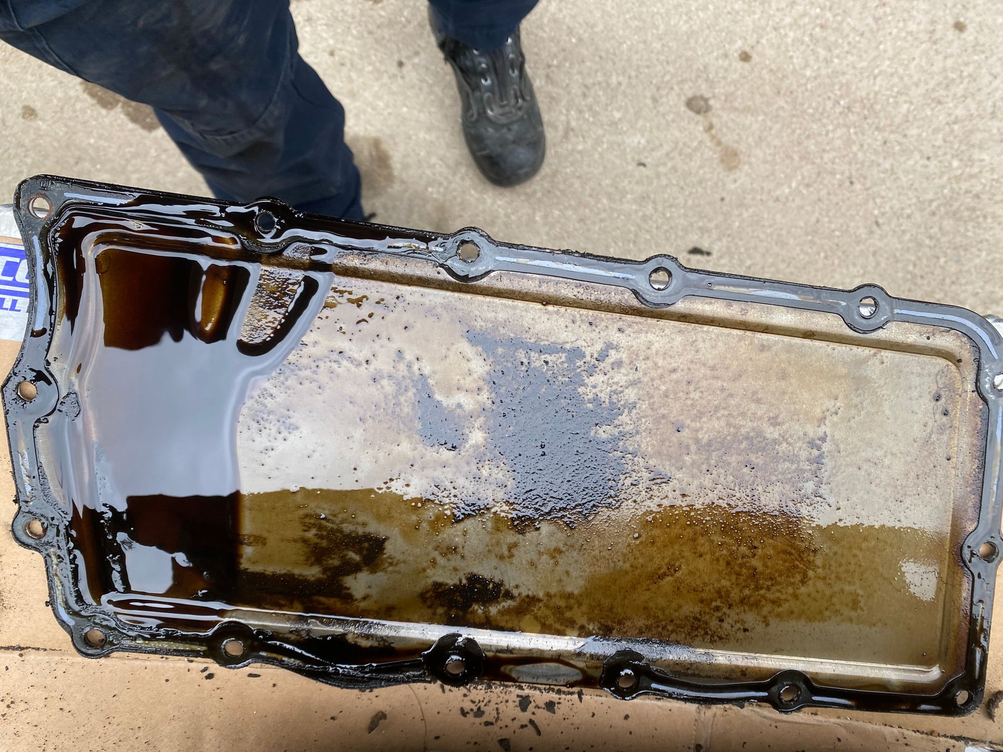

Well it appears this has been re done before but definitely blown out again #3 bolt from left on bottom was loose as well.
new pan on and torqued

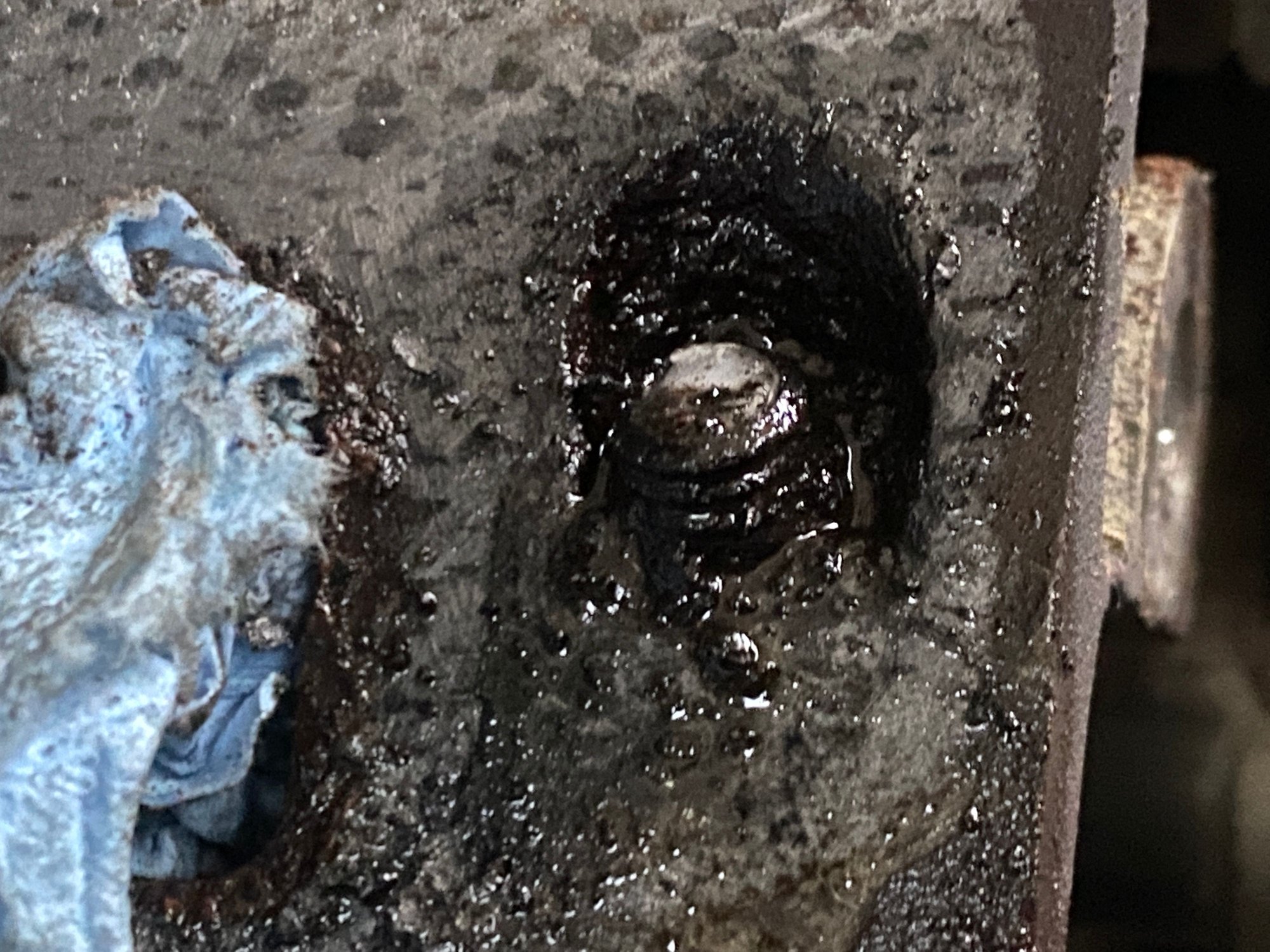

unfortunately I broke one bolt getting it out.
soaking in pb blaster.
time to make supper get back at it later
well 13:00!hrs it is finally out between torch Kroil and lots of wiggling and finally hammering the vise grips down beside it to get a bite I started on it at 09:00 this morning
