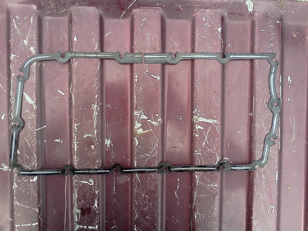

Originally Posted by PapaG
Actually its all still in one piece so when I get home in a couple of days I will post some pics. Down in Knoxville for a few days working.
Cool, I'm just curious to know if it might have been leaking between the gasket and steel plate, and it just wasn't falling apart yet.
Honestly, thats EXACTLY what it looked like to me. There was a LOT of oil in the intake and I didn't see that much coming thru the PCV valve, but there was no inward bulging of the gasket. There were several spots that looked like the oil may have leaked between the gasket and the plate. Will post pics in a day or two.

Hey Zman finally got a chance to get some pics of the gasket. It didn't come off the plate in one piece though. Here is the pic Name:  IMG_20120417_120821.jpg
The only places that were really stuck were right at the edge of the bolt holes. The gasket between the bolt holes was loose enough for me to take the blade of a knife and slide it between the gasket and the plate.

Thanks for posting the pic. I'm thinking it was leaking.
