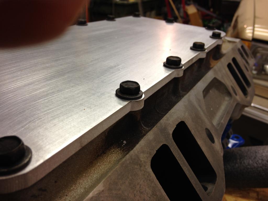

Is there any reason for the aluminum plenum plates i see on the market having the bosses around the mounting bolts? I speak of the ones highlighted in the photo below
I'm looking at fabbing up a plate as I have some scrap aluminum sitting around that would be perfect for this. I'll be replacing the manifold gasket in the summer, so might as well. I don't see a particular need for the bosses on the plate unless the spanned sections between the bolts are recessed for clearance concerns?
I think it's just a 'pretty' thing..... there *might* be some clearance issues if you just have the sides straight...... just have to be a bit more creative installing the manifold. It would also leave a nice 'shelf' for stuff to accumulate on...... not sure it that would be detrimental or not....
