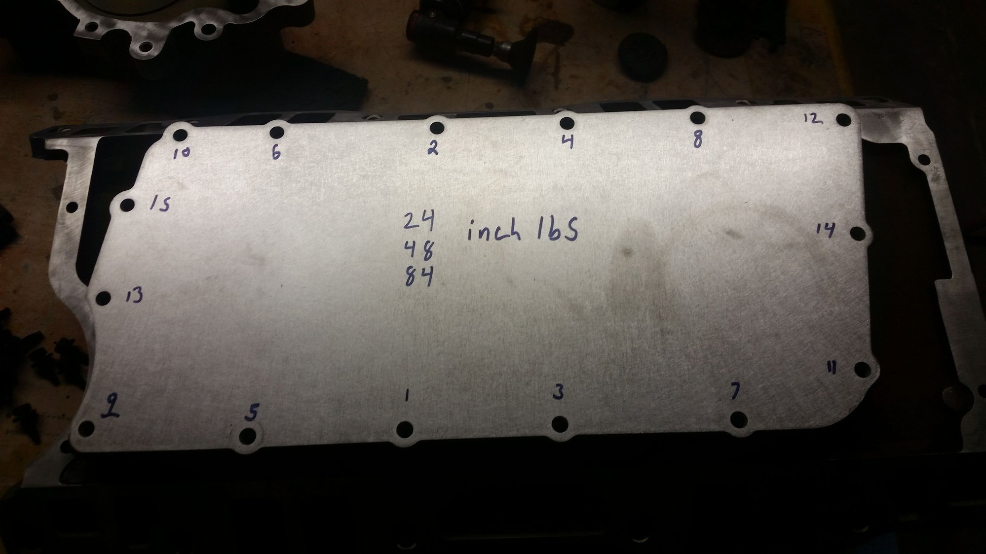

Don't know if this will help anyone, but this is what I did on my plenum plate tonight so I didn't have to stare at the book and get lost on which bolt was which.
Tightening sequence and torque specs. Tighten in 3 stages... 24 inch pounds, then 48 inch pounds, then final torque at 84 inch pounds.

Thats a good idea! Save time and money. Dont forget the blue locktite.
"An ounce of prevension is worth a pound of cure"

I did the exact same thing when I did mine, haha! It was a life saver!
