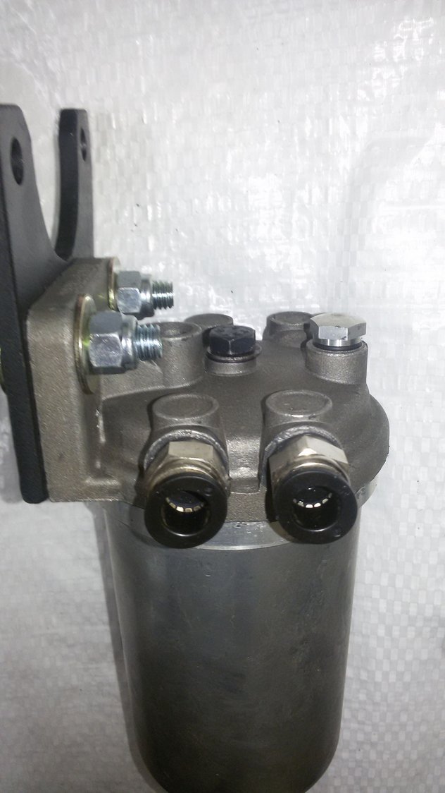

I noticed that if you turn the pcv valve 90 degrees the flow rate changes too. I put together my oil catch can based on some I saw online using a diesel oil filter housing that I modified and I think it is very efficient and will not restrict flow.
I also noticed that despite the fact my catch can allows good flow when I plug it the flow rate drops quite a bit. If there is no oil on the hose on the other side valve cover the flow should be enough. I have even measured the blowby this truck does to compare with the PCV flow, if you are interested I could post that some other place. I really think I have one or more bad valve stem seals at this point.
