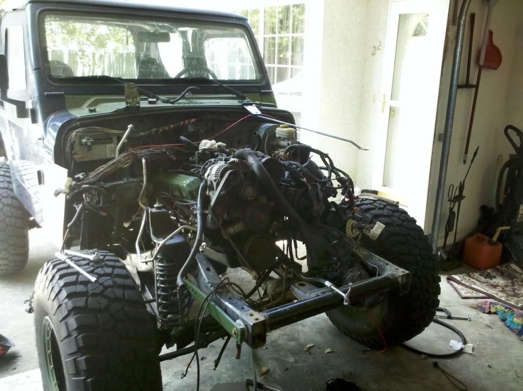

Well I was going to post pics of the the flywheels next to each other, however; my phone didn't save the pictures I took. But they were the same except for notches machined into he new one. I got it installed last night, but my girlfriend threw away my clutch alignment tool, so I've been trying. To get everything lined up and trying to get the tranny mated to the motor. Ill have it done today and hopefully fire it up. But ill post some pictures of the swap.

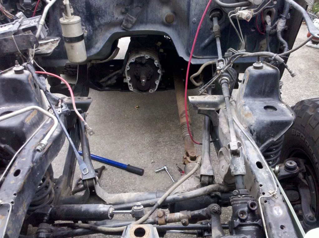

Sorry about the huge pictures, photobucket isn't letting me resize them
Old motor ready to be pulled

4.0 out
