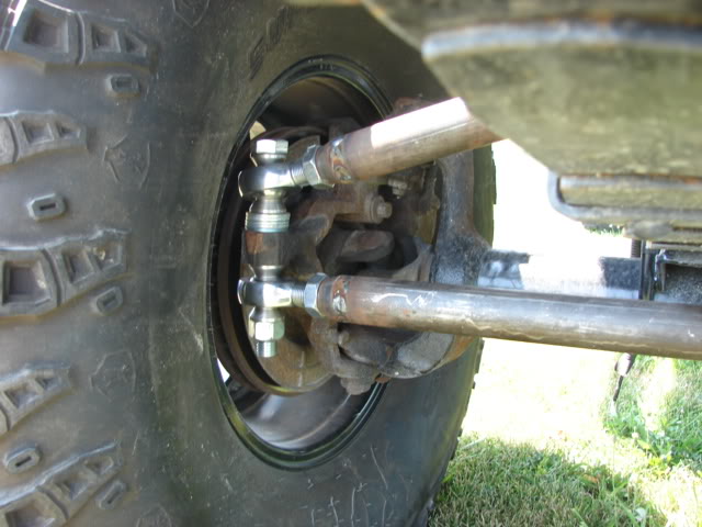

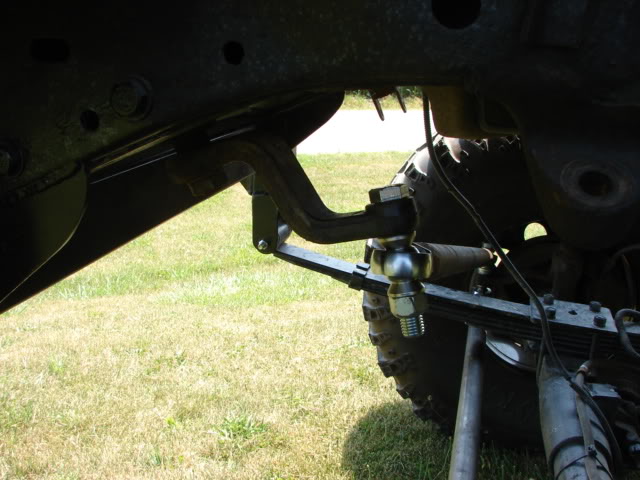

so i finally got my steering and got it setup. what are you guys thinking about the angles on it?
next week ill be ordering shocks and steering stabilizer, then gears...

The drag link looks to be a tad steep, doesn't look like there is much angle left in one direction... It isn't going to hit the leaf when you turn sharp to the left is it?? Wonder if you could get some flavor of "high steer" adapter on the knuckle, to reduce the angle some?
