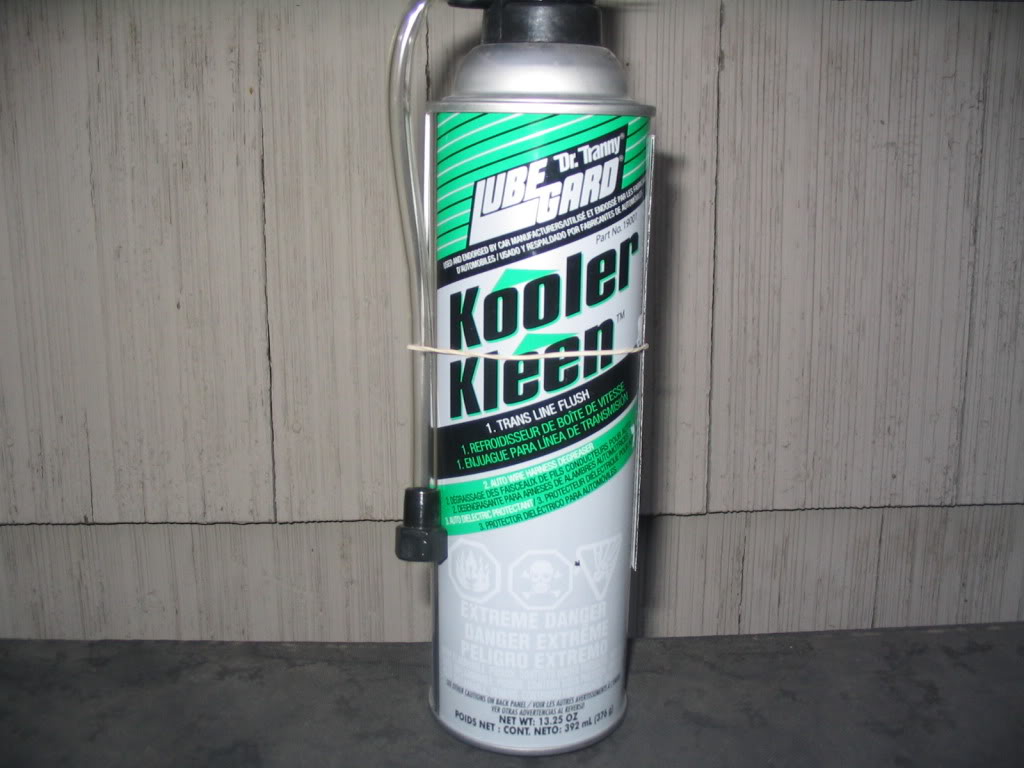

So how are you gonna clean the trans lines? MAKE SURE YOU CLEAN THEM OUT VERY WELL!!! I thought I did, but it turned out that I still had some small metal flakes floating around. Also, I installed a remote trans filter...good cheap insurance.

I never thought about a packaged product for this. Gotta check Autozone and O'Reileys tomorrow. (I can probably do that even with the hamstring thing...)
Where did you get it?

O'Reilly's. They didnt have it on the shelf, but they had some back by the "pro desk"...ya know the commercial parts delivery area. $7.99 a can.

Small town - no "pro desk" but maybe they will have it. If not, I'm sure they can order. Think 2 cans will do lines and cooler both? I wnat it clean before I install cooler and fill er up!

I got 2 for mine. Mine had the tow package so it goes through the radiator and an external cooler. I'm thinking one can would be plenty, I just bought the second one for next time I wanna flush the lines. Or in case I was wrong and needed more than one.

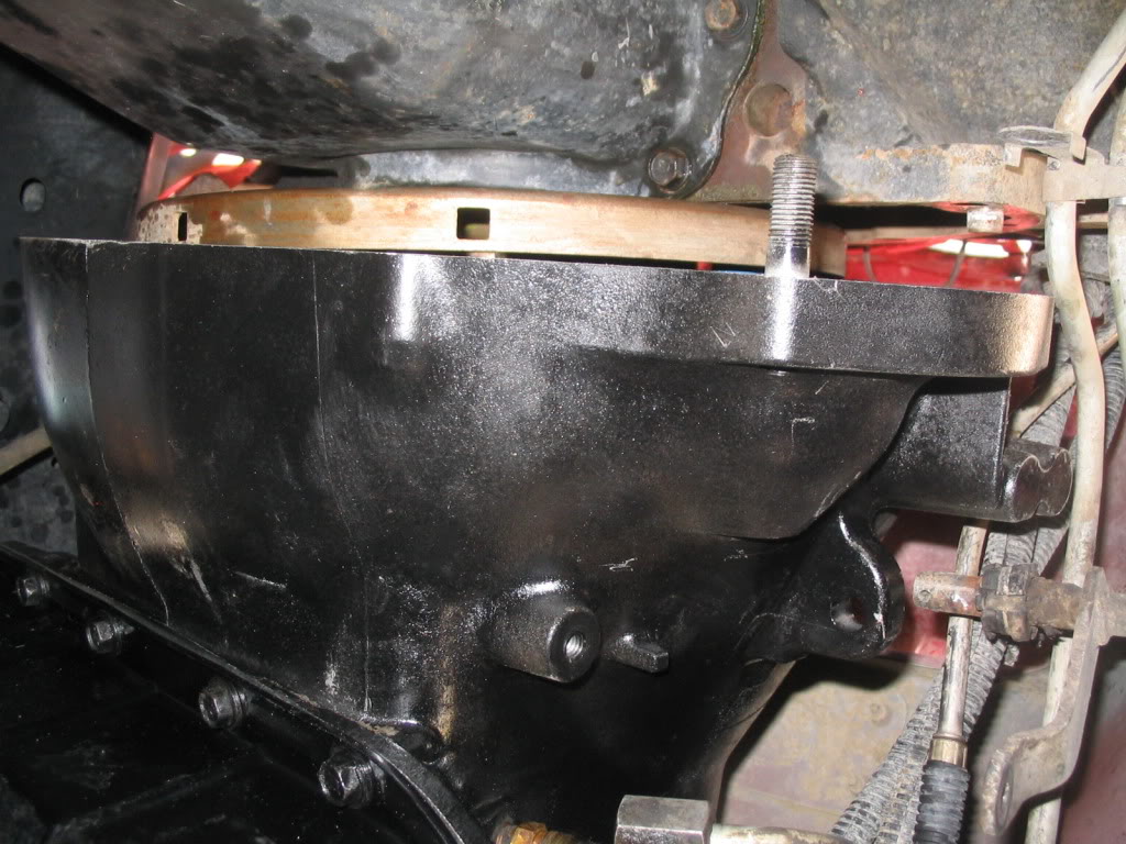

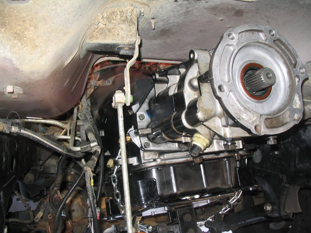

So close....Now I'm thinking my converter isn't seated fully because I'm about a half an inch from seating on the dowels. Dang it! I don't wanna have to pull it back off the jack, back out from under the truck just because the converter moved out slightly...I suppose it's a no-no to use the bell housing bolts to draw it in, eh?
