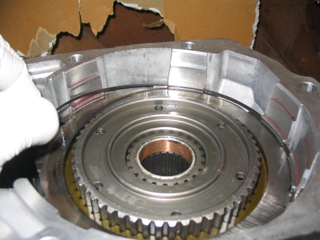

Ok here we go. I chronicled the teardown and will post quite a few pictures. We'll start with the face of the extension housing face up with the machined bars I was using for my measurements.

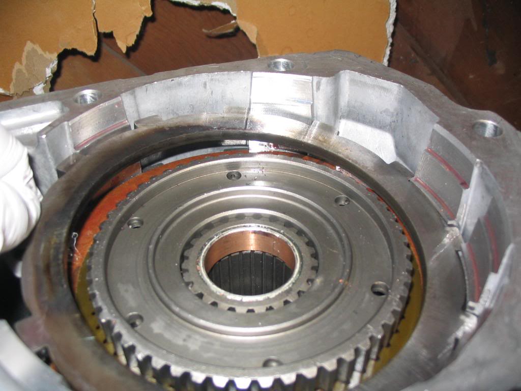

From: Crawlorado
Removing the round retaining snap ring.

Removing pressure plate from O/D clutch.

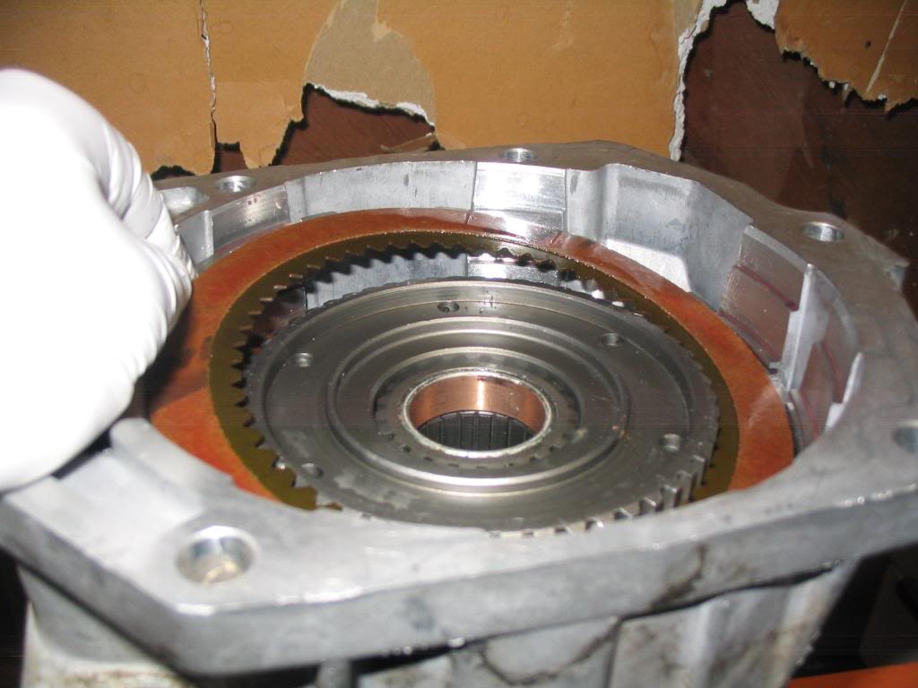

From: Crawlorado
Now onto the frictions and steels...

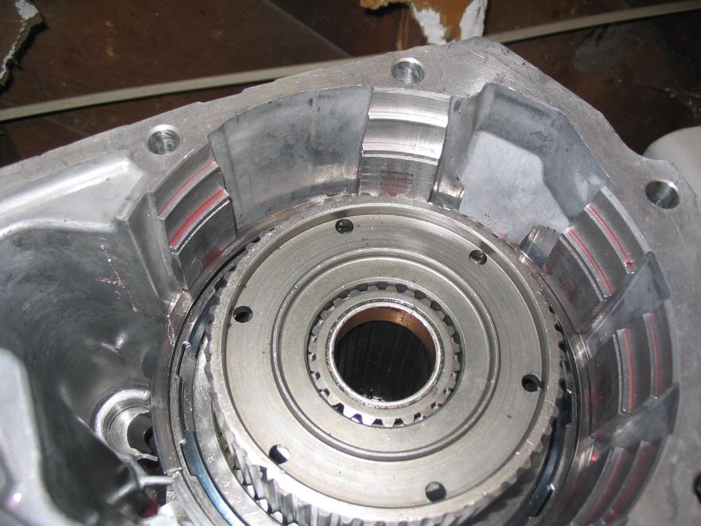

O/D clutch removed.

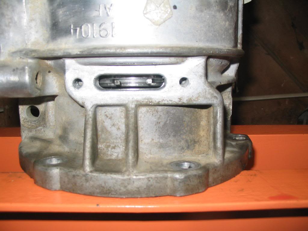

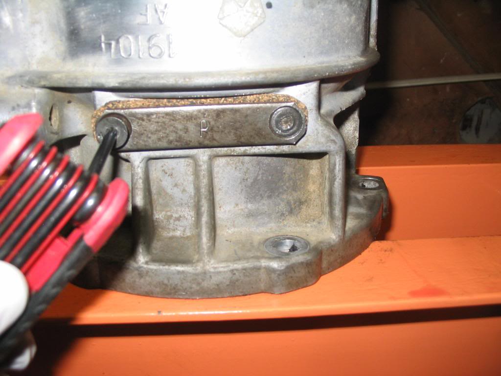

From: Crawlorado
Removing access cover.
Removed.
