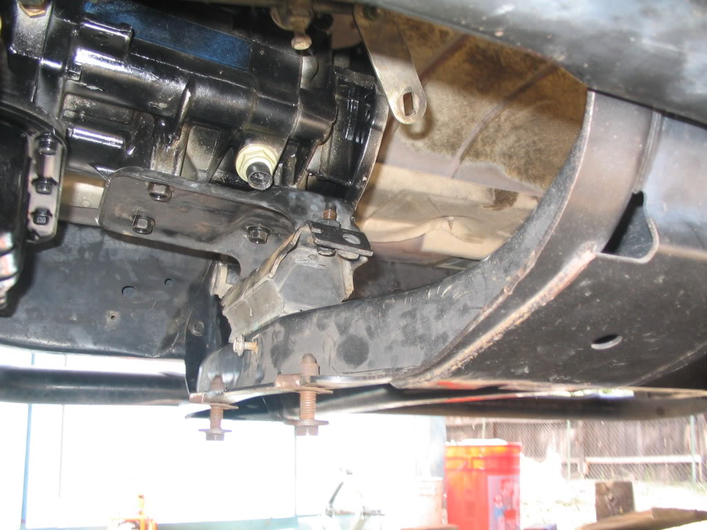

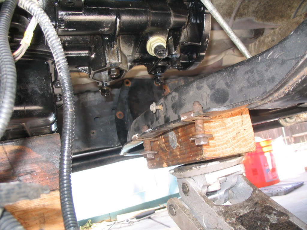

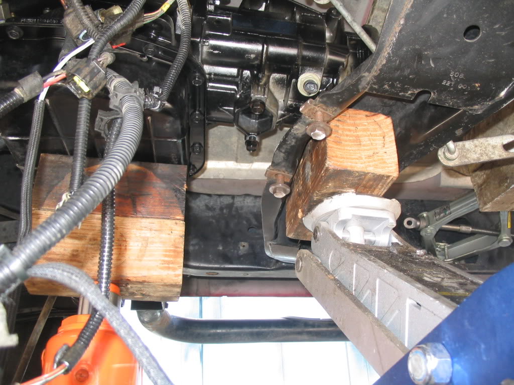

It's all good, read through the DIY section stickied at the top. Theres manuals and tons of links. So I finally got the cross member in this morning. Just had to get the tranny jack out from under the tranny and put the cross member in from the front of the frame. It was super easy just using a floor jack with a cut 4x4 in the recess of the cross member to lift it in front of the mounting spot, then just slide it all rearward. No hammers involved.
