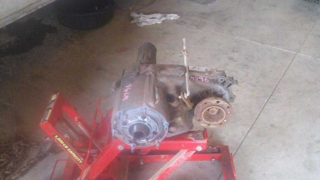

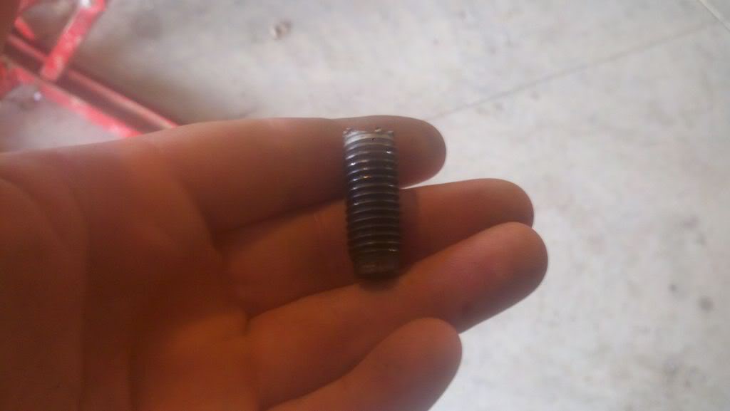

Thank you i will check that out. I just got home from picking up the new Transfer case. gonna make some lunch then head out and start wrenchin!!! First gotta get that bolt out.

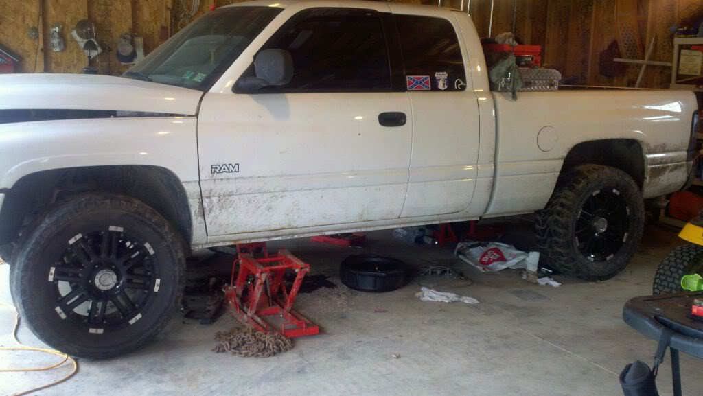

Ok well i got a few things done. The first picture is of the transfer case all cleaned up and ready to go in. The second one is of the pesky bolt that i had to get out. and the last one is the truck hoping that its the last night in the garage. I also went out and got a new wheel speed sensor to hopefully fix the speedo problem along with the Brake and ABS light.. after all this is done its on to fix the shifting problem. Thanks for all of your advice guys. Hopefully have pics of the truck out of the garage later on.
