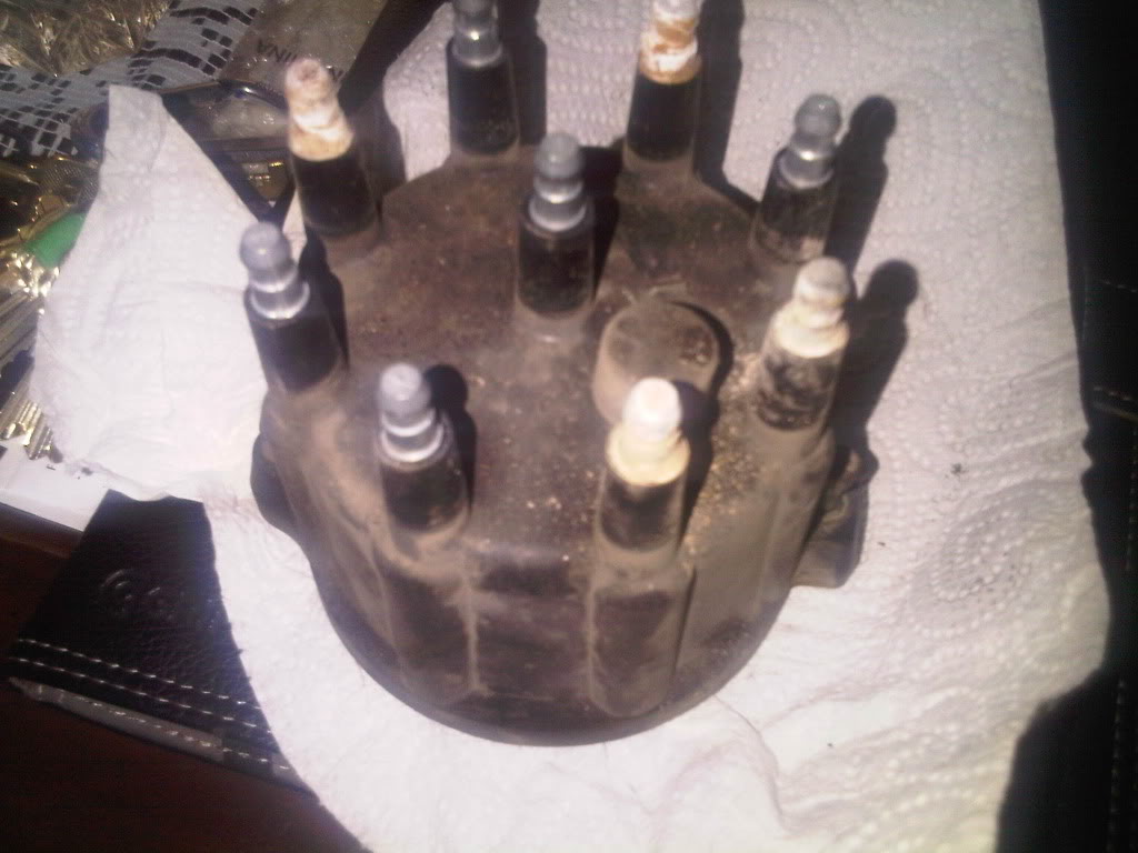

Well a little more work done this afternoon, and another discovery.
I am surprised that I was only getting an occasional cyl 8 misfire. SHould have been getting a 4,6, and 7 misfire as well. Wires were Mopar, and ad neglected as this truck was, I am reasonably sure they were factory install.

Make sure you get quality distributor cap with brass terminals. Replace the rotor bug as well.

Put on MSD rotor and cap with brass terminals. Also MSD 8.5 mm wires and new plugs.
Darn thing won't start. Checked fuel pressure - it is 49 lbs. Injectors getting pulse (MTG 2500 testing). Going to check for spark next. Acting like no fire. After a few seconds cranking, oil pressure comes up and and I get a "check gauges light" and ABS light briefly.

Truck cranked right up, and is idling smotther than it has since I got it. Gotta love it when a plan comes together. Between plenum being shot, cap being corroded (see photo in above post), original wires, and worn timing chain, it is hard for me to believe it ran as good as it did.
