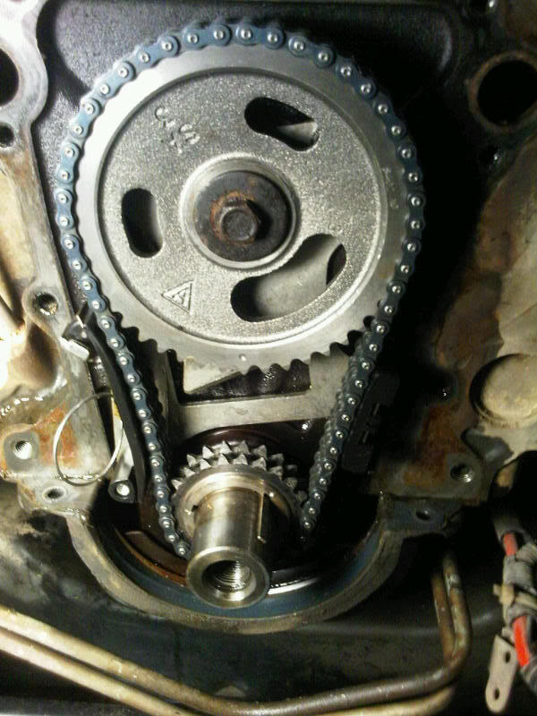

Originally Posted by zman17
Maybe it's me, but some thing doesn't look right about how those 2 gears are lined up.
I thought I would follow up and clarify this question posed by zman. I know how confusing it can be to read a thread and see information that appears to be in conflict. (And I never have a problem with someone pointing out something and questioning it. It is easy to overlook something and great when someone causes me to double check. Sometimes save a "DOOOO" moment! Thanks zman - your questions and pointing out things is very helpful)
The question was related to the timing mark on the crank gear. There is a mark on the tooth that is in the 12 o'clock position that is not clearly visible. Note the alignment of the crank key.

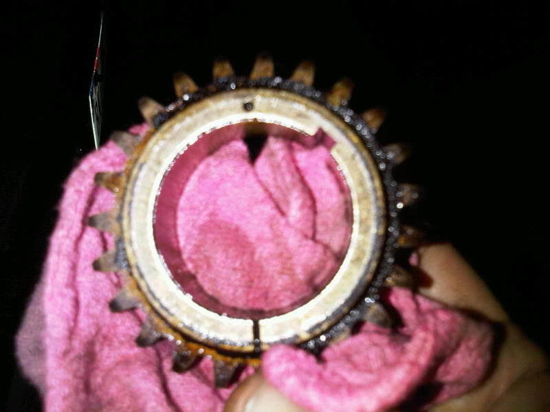

The following photo is the original crank gear. The timing mark is on the boss of the sprocket and not on the tooth. Note the position of the crank keyway.
I think an important thing to keep in mind while doing this task - when disassembling, do NOT change the position of the cam or the crank. I hope to be able to get this finished up this weekend and crank it up. Been oout of town last couple of days, and decided the other day to stop and wait for new o rings (no one had them in stock). I dislike using old seals and o rings. My luck has always been to have leaks afterwards...
