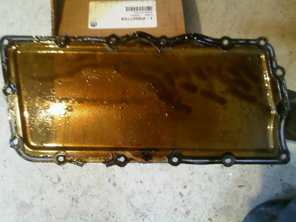

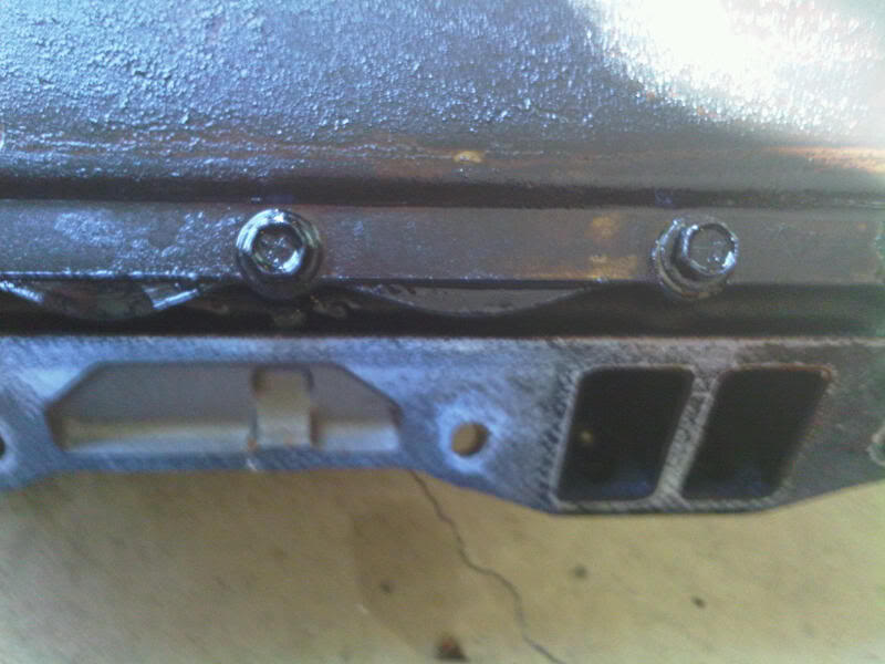

Got intake pulled out and only broke off one bolt. Cannot understand how I got lucky by one on the front breaking off. My luck ususally would have had one at the back break off! While letting broken bolt soak in penetrant, I pulled plenum pan off to see how bad the gasket was blown:
You can see some of the gasket pushed out - and where a piece is missing - probably in the oil pan...
Don't know if they get any uglier than this one or not....
