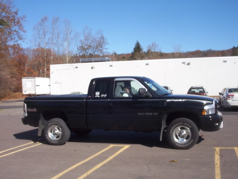

here a youtube video on replcing the dashcap on a 98 ram.
http://www.youtube.com/watch?v=wfV1SvKv90cName:  000_0315.jpg
Old Nov 4, 2011 | 05:56 PM
stewie01's Avatar
stewie01
Joined: Mar 2011
Posts: 8,914
Chevy 4x4 logo in the rear?
